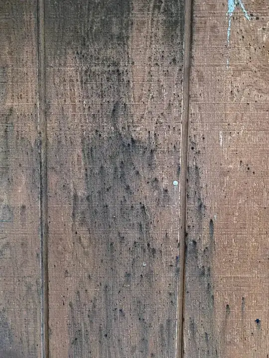

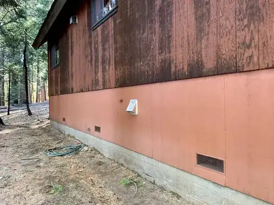

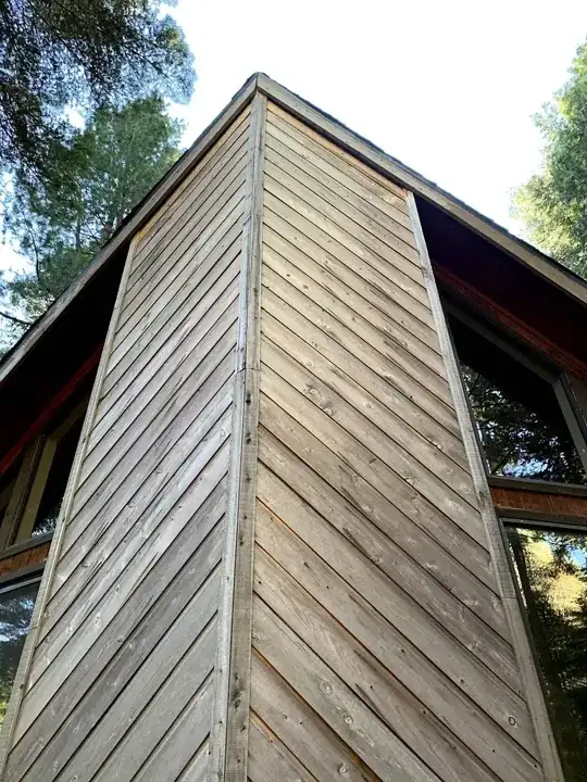

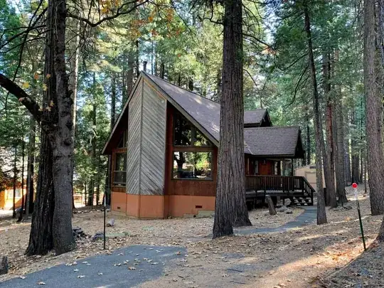

The cabin has old stained t-111 siding with untreated graying Pine (or maybe Cedar?) siding on the chimney, (the chevron pattern in last photo). Its heavily weathered but not cracked or rotted so I think its ok to refinish. The previous owner didn't do much maintenance and the forested location means it gets very little sun, so it has some mold/mildew growth. I'm planning on a dark gray/black stain on chevron pattern siding and charcoal gray paint on the rest of the house (however part of me wonders if this is a bad idea: a dark color camouflaging future mold/mildew). Anyhow here's what I'm thinking:

  5. I assume I'll need to apply a wood conditioner before staining the chimney siding since its so weathered?
  6. Stain chimney siding (If it turns out like crap I can always just caulk and paint over it).

I agree with others to clean prior to calking. I do not like pressure washers on stained or almost bare wood it really can tear the soft grain up and leave it looking like crap.
I prefer cleaning the wood with deck cleaners or hydrogen peroxide. The hydrogen peroxide will kill the mold and brighten the wood (sometimes people don’t want bright)
I purchase gallons of ~12% hydrogen peroxide online. I used to get ~30% the stuff smoked when you opened the bottle From a chemical warehouse.
I use hydrogen peroxide at +3% , AAA for safety (always add acid to water) this is stronger than the store Stuff I mix small batches and test.
usually the weakest solution I will use is 3% like what you get at the store, going stronger can really brighten the wood but needs to be rinsed off. I like putting it on wood with an automotive type scrub brush on a pole. I work it quickly and evenly into the wood.
I start at the bottom work up and if I notice it is getting back to the color I want I rinse it off and continue working up. If you start at the top the wood below gets wet from rinsing and in my case had a uneven look that required an additional little scrub , by starting at the bottom I found rinsing did not affect it so much, peroxide probably cost as much as many deck washes. for mold only 3% is needed to kill it, around 7+% starts brightening the wood and it did not stink like some of the chemical washes. You might try 3% a quart from your store and sponge some on straight if you don’t like the results you have only wasted 2$ But it will kill the mold.
As far as your concern about color and mold after once you clean and paint the wood will be sealed and less prone to becoming moldy.
I live in Oregon and after finding out about hydrogen peroxide while working in a hospital have used it extensively to not only take the mold color out but to take the musky smell associated with mold and mildew out without the bleach or other harsh chemical smells.
Just don’t get the stronger hydrogen peroxide on your clothes as it will turn them white. And AAA.

That's a nice lookin' place! Well worth the effort to spiff it up!!
Swap steps 2 & 3. Caulk will peel off when any loose material under it gives way. You want a good, solid, well attached substrate before any caulking, staining or painting.
If you're renting a lift, you can apply the pressure washer pointed down from above, just get more hose and a longer extension cord (make sure it's heavy duty to handle the voltage drop over the distance you need to run it). Be aware, though, that pressure washing the grey off that chimney is going to be hit 'n miss. Literally. I just pressure washed my deck after 2 years of sun, and it was very difficult to get an even finish. We applied a sealer only to our deck, so the unevenness is very obvious. It may be less so with a dark stain, but I'd imagine that some of it will show through even a black stain. If you paint it, the paint should cover without an issue.
"Wood conditioners" are usually just thinned versions of whatever finish you're going to use, and are of limited value. The main issue you'll see is that your really dry, weathered wood will suck up a lot of whatever finish you're applying. If you're painting, you may need to apply a couple of coats, the first one or two to quench the wood's thirst while later ones will actually sit mostly on top. If you're staining, keep applying until you get the color you're after. If you have more questions about wood conditioners, pop over to Woodworking and check out the [finishing] and [staining] tags.
Finally, I'm not sure why you wouldn't caulk all joints, whether you're staining or painting. The purpose of the caulk is to seal gaps to prevent air and moisture infiltration. If you're staining, maybe use a colored sealant to get close to the final color you're after, or use a clear silicone so it's not too obvious. Either way, you don't want either air or water leaking under your siding.
