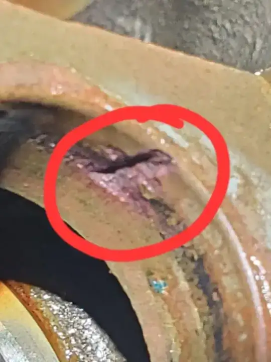

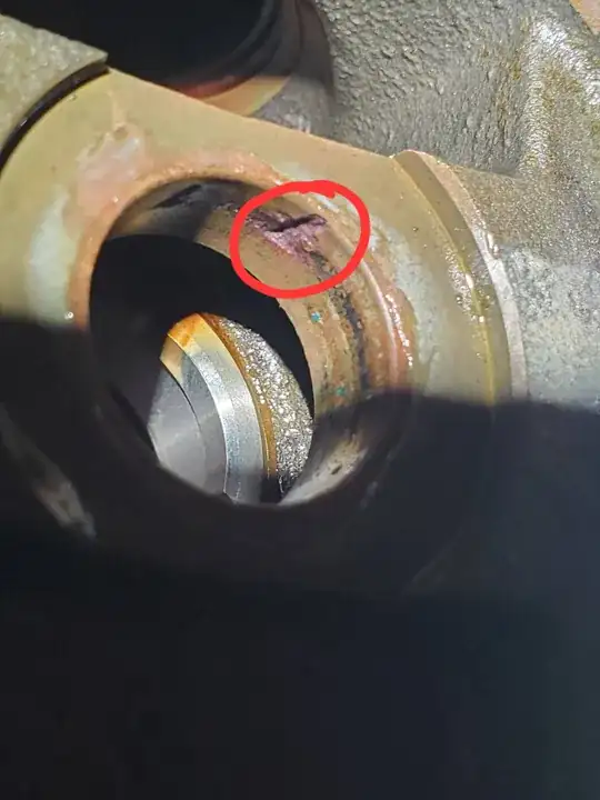

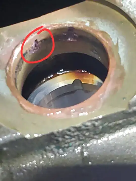

I pulled the valve apart again after re-installing, and I noticed two large chips in the bore where the stem unit sits. The chips straddle where the O-ring sits in the bore.
My theory is that those chips in the bore are allowing water to bypass the O-ring, and so not maintaining the water pressure.
This theory is inline with the behavior I saw where the pressure slowly increases when measuring immediately after closing a running faucet; a little bit of water slowly seeps through those chips raising the pressure in the house system till it reaches parity with the city pressure.
I can't explain how those two large chips got there in the bore, though.
I'll go to hardware store today and buy a whole new unit, and see if replacing the whole thing fixes the issue.
But maybe you have a similar issue that the core unit is bad...
