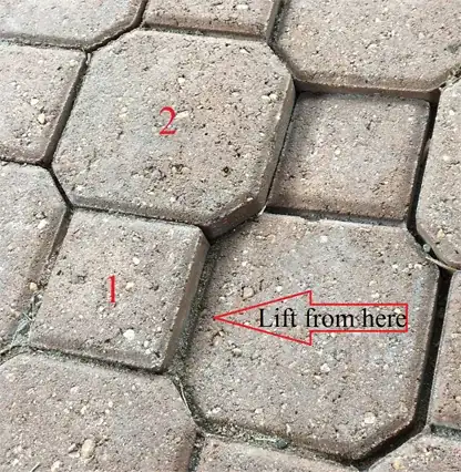

I have a couple pavers that have sunk in my driveway. If this was close to the edge, I’d take up a few, re-level and replace. But this is in the middle of a large expanse of pavers.
driveway pavers
How can I pull up a few in the middle to fix this without having to pull apart 1/2 my driveway?

    Don't try to start with the sunken one - go for the ones **around it** first. – Ecnerwal Jul 13 '20 at 23:40
  • yes, once you get the first one out, the rest will be easy. – George Anderson Jul 14 '20 at 00:35

Using a crowbar or screwdriver etc. lift the pavers to the left of the sunken ones first. Lift the ones numbered 1 and 2 in the image:
Then you should have enough room to dig out the sunken ones.

  • I've done this (without modifying the spatulas) to lift a row of tiles from the middle of a piece of pavement to put some low voltage wire under them. It works. Slowly "crank" the tile up for a few mm at the time from each side. For OP's case, I'd place them on the North and South side of the lower tile in the picture, otherwise you'll wedge it stuck. – CodeCaster Jul 16 '20 at 16:18
