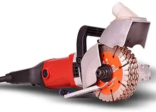

Use the a wall chaser, this is a tool electricians and plumbers use to cut chases (small trenches) in concrete, but fit only one blade (use a washer in place of the other(s)) do one cut from the top and one from the side.

  • What tool would that be, and why would it have more than one blade? This answer is confusing and incomplete. – isherwood Jul 20 '20 at 14:17
    It's a wall chaser, very common in Germany for example where pretty much all walls are full masonry. See my answer here: https://diy.stackexchange.com/a/185938/65622 It has 2 blades to make 2 parallel cuts at once in order to make a chase or slot in the wall. – PhilippNagel Jul 20 '20 at 14:38
    Sexy tool. I do not need one, but i **want** one. I could see that having it when you need it would be very useful. – Alaska Man Jul 20 '20 at 21:03
  • you can probably rent one – Jasen Jul 21 '20 at 06:05
  • It's like a hand-held dado stack for concrete. What's not to love! – FreeMan Jul 21 '20 at 13:16
