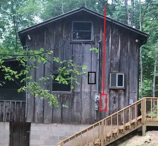

I am renovating a cabin including complete re-siding so I thought I would use this as an opportunity to upgrade the electrical service to 200amp (currently 100amp). Two reasons, 1) might want to add real HVAC in the future, 2) the current service is not up to code and down-right dangerous (as you can tell from the attached picture). In the picture the black box is the location of the interior (now main) panel. The red box is my proposed new meter/panel location/mast.
I was going to do this by putting in a 200amp panel outside and make the interior 100amp panel as a subpanel.
The building is on a steep hill and I need to add a handrail about 36" above the stairs and if I need to keep the meter no more than 6' above "ground" level that gives me approximately 36" for panel and meter if stacked (I need the panel above the handrail so it can open). I'm not excited about having the meter and panel side-by-side (making 4/0 Al bend around corners seems a lot of work) so I've been looking at meter/panel combos such as the Square D SC2040M200C which puts the meter roughly at 5' above "ground" level and gives me 20 spaces. Or the SC3042M200PS which is a little less deep.
I tend to shy away from "combo" things as I feel they eventually limit your flexibility however, I can't imagine 200amps in a load center with 20 spaces/40 circuits wouldn't serve me fully in the future (famous last words?).
Comments on the combo panels and this panel in particular?
Thank you. enter image description here Addendum:
I surveyed the area again this weekend and unfortunately there is a huge tree in the way of moving the utility supply any further to the right. As it is, where the service attachment is now, the service drop runs a little less than 5' feet away from the tree. I talked again with the inspector who admitted "it's best not to" have anything over the stairs but felt the meter was OK as there wasn't another good level place for a drop. He agreed to leaving the meter where it is (but lower) and running to a panel in my basement even though the clearance is only 6'3" high from floor to ceiling in the basement. I asked him about an outside disconnect and he said it wasn't required (yet) but a good idea and recommended a "combined meter base disconnect".
This leaves me in a quandary - Leave the meter where it is and put the panel inside (both of which are not 100% compliant) or something else. I could put the drop to the left (as per my updated picture); this should be an acceptable landing but puts the panel in the way of "traffic" and the mast head will be close to 24' above ground (30' maximum I believe). I also don't relish the idea of having to bore through cinder block (or should I exit the panel on the side and run my branch feed through the rim joist like my pciture?). However, this should eliminate concerns about meter location, panel location, and height of my basement).
Any additional suggestions at this point would be greatly appreciated (@ThreePhaseEel et al). enter image description here

    Who is your electric utility? They may have something to say about a meter socket above a stair to begin with – ThreePhaseEel Jul 22 '20 at 01:49
  • Also, are there fuses in the disconnect box below the current meter socket? – ThreePhaseEel Jul 22 '20 at 01:52
  • I've already had the inspector out who agreed with my plans in general. He didn't have any problems with the current location, just the mast location. Although I haven't asked him about specific panel/meter equipment. The existing panel is a Murray with breakers. That little box below the current meter box is a solar panel disconnect. It will be moved. – drjrt Jul 22 '20 at 01:57
  • 200A sounds like a lot. Not a 200A panel, that's fine (irrelevant) but 200A service for a cabin? What kind of kitchen appliances? Hot water heater? Clothes dryer? – manassehkatz-Moving 2 Codidact Jul 22 '20 at 02:13
  • @drjrt -- we need to know who your *utility* (aka your power company) is, because they might disagree with your electrical inspector's OK (and I'm also mildly surprised your electrical inspector OKed that location to begin with) – ThreePhaseEel Jul 22 '20 at 02:24
  • Full size range, fridge, water heater, plans for small washer/dryer in basement. And we really need AC (alhtough I was going to go with a split unit that appears to only need 15amp 230V). – drjrt Jul 22 '20 at 02:26
  • It's Jackson County Rural Electric. They pointed me to the inspector. I will call and confirm. If they don't want it above the stairs (why is that an issue if we don't exceed maximum meter/panel heighth?) then I can move it to the exterior wall to the right. Still same question about panel. Bottom line I am going to change the service regardless; I'm not going to let them re-side this structure with the service wires hanging in their faces. – drjrt Jul 22 '20 at 02:29

  • I guess I could put the new panel in the basement. Still does not address the concerns the others had about meter location (above stairs). I’ll check with REC contact tomorrow. – drjrt Jul 22 '20 at 03:31

  • I would think that your updated location (BTW, put the original pic back in for completeness) looks like the best bet. Sure, at 24' you're close to the max of 30', but you're not there, so that's not an issue. I'll leave it to the experts to address all the issues, just my thoughts on 1 particular item. – FreeMan Jul 28 '20 at 15:59
  • @FreeMan - I've added back the picture. Contacted the Utility company who is going to survey my site and make sure the span isn't too great to this location on the left. Thanks for everyone's input. – drjrt Jul 28 '20 at 18:27
  • One other option, though not necessarily a preferred one. You indicated that a straight shot from the current pole to the right of the cabin for a new drop was blocked by a tree. An additional pole among the trees would change the angle of approach and get around said tree. Maybe not favorable (and potentially a lot more money), but an option to consider. – FreeMan Jul 28 '20 at 18:32
  • That's an option I will discuss with the utility people. There is a reasonable place for a pole that would cut the span in half and allow the drop at either end of the house. Not sure what the cost of pole would be; does the utility company do that then charge me or do I have to find someone to put in a pole? – drjrt Jul 29 '20 at 01:24

I'm surprised your inspector is willing to sign off on a rather clear Code violation
Putting a breaker panel, meter-breaker, or any sort of overcurrent device over the steps of a stairway, as you are proposing to do, violates NEC 240.24(F):
(F) Not Located over Steps. Overcurrent devices shall not be located over steps of a stairway.
So, if you want to use a meter-main for this job, you'll need to move the service mast to a place where the clear working area in front of is on flat ground; while around the corner to the right didn't work, placing it where you describe off to the left side would provided the service drop can reach there. Amazingly enough, though, your utility's service requirements for overhead service do not expressly prohibit mounting metering over stairs, so if the service mast can't be moved, that'd be a good reason to have a separate meter base and main panel instead of a single combination unit.

    So to be code compliant it appears my options are to keep the meter over the stairs (+/- a disconnect) and place the panel over level surface (probably inside basement) OR move meter, mast, and panel (combo vs separate) over level surface. Disappointed my paid inspector was going to let me violate code. I’m sure the utility company would have restored service as long as I had his written OK. Thanks. – drjrt Jul 22 '20 at 05:11

  • While there is a nice basement for a panel, there is a raised floor that provides only a little over 6' high clearance (thus not meeting 6.5' high requirement). My other possible issue I believe there is a very large tree between the pole and bringing the service to the right side of the house on the level surface. If not, to avoid "special dispensations" from Utility Co and/or inspector, I will put meter and panel on the right side of the house. – drjrt Jul 22 '20 at 17:21
  • @drjrt -- you might be able to have the service drop run over the gabled end of the roof to a mast that is "periscoped" down through the eave on the right side near the corner.... – ThreePhaseEel Jul 22 '20 at 23:30
  • Good idea. I'm going to go back down there an re-survey with all this new information this weekend. – drjrt Jul 22 '20 at 23:57
