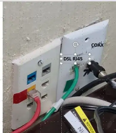

The picture below is what I believe you were originally trying to get an answer for. At various time and just recently, I had both Coax and DSL services. I wanted to make sure my new services and cable were working before terminating one of the services.
The Outlet box on the right has two slots, one for RJ45 (DSL) Service IN, and the other one is for coax Service In.
The panel on the left is for ethernet connections on the 2nd floor to a switch which distributes ethernet access to all the rooms upstairs. This was setup and configured before wifi.
