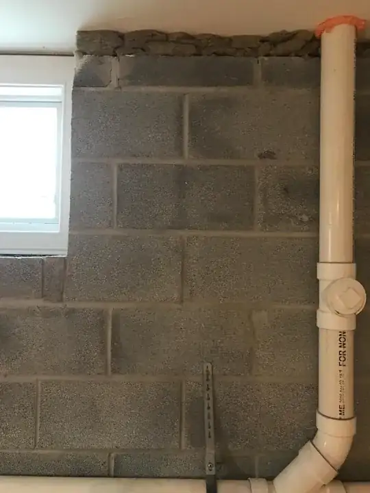

I will run #10 Cu ground wire. All THWN to run above ground in shared conduit thru and along outside of brick wall under an eave in Virginia. For ampacity, no temperature correction has been applied but 5 current-carrying wires in conduit calls for an 80% adjustment. For conduit fill we have 2@#8 (0.213), 1@#10 (0.161), 3@#12 (0.128). With 3/4 SCH 40 PVC conduit I estimate less than 30% fill (I am permitted 40%).

From sub-panel to outside From sub-panel to outside
