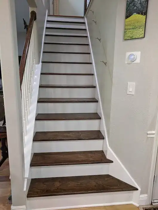

We removed the old handrail that was not up to code and didn't reach the first step of the stairs as required. We have a traditional guardrail installed on one side and we are having difficulties trying to find a good method of continuous transition on the other side, that has a wall angled 45 deg away with the first two steps. The handrail needs to terminate on the first step, not near the third.

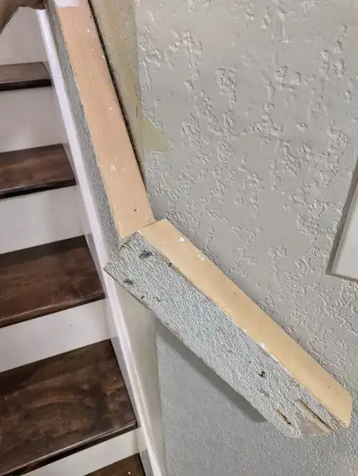

Since we have traditional handrails, we can't make a simple miter cut because the short piece's top orientation will start to point away from the wall. With circular handrails, this is not a problem as there's not top/bottom.
How can we get a good/decent transition?
Stair slope: 41.5 deg
Inner angle of walls: 135 deg leveled (following the handrail path, the inner angle becomes 145 deg)
Stairs
Trouble wall
Example cut showing rotation needed to remain upright and proper distance
Traditional handrails being used

    3rd picture ... the cut needs to be parallel to the corner of the wall and at about 67.5 degrees ... same cut as the baseboard ... extend the lower section all way to corner where the two walls meet... trim off the corners that stick out – jsotola Jul 27 '20 at 00:07

Typically it is done with a miter cut to get to level, or up easement, then a 45 degree level turn , then another miter cut to resume the angle or over easement, this will get the job done. You can do it with all on-site miters, or you can purchase "fixtures"... parts that are "pre-bent" to make smooth turns. Where I have "up easements" or "level turns" or "over easements" is the names applied to these fixtures I referred too.
I would suggest using glue and "biscuits" to join these parts together, since they will be small enough so there will be no strength in just using screws alone. enter image description here enter image description here

    As a mention, you will need to sand the joints undoing any prefinishing that has been done – Jack Jul 27 '20 at 00:47
  • I have done miter cuts in the past the inspector asked me to add an additional bracket at the joint on 1 house but other than that as long as the transition was smooth they never said anything. – Ed Beal Jul 27 '20 at 14:19
  • This is exactly what we needed. Can't believe it's actually pretty simple. Thanks! – Ben Williams Jul 28 '20 at 14:20
  • @Jack would it be possible for the two small pieces to become one if the ends were compound cuts? – Ben Williams Jul 30 '20 at 17:33
  • You will need to elaborate a little more for that one, but as much as I have done in the past and variation from the sketch will result in the twist you depict in the picture with the mock up. – Jack Jul 31 '20 at 04:23
