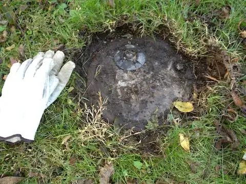

My meter is by the street, under this cover (gloves for scale): enter image description here
Is it possible there's a PRV in there? I couldn't pry the lid off with a screwdriver. Do I need a special wrench for one of those fittings to get in there? Am I even supposed to open that thing?

    Do you have a [pressure reducing valve](http://pressurereducingvalve.net/wp-content/uploads/2012/07/pressurereducingvalve.jpg) on the main water line (should be near the meter)? – Tester101 Oct 15 '12 at 19:24

  • No PRV in basement, might it be in a vault by the street? See question edit. – Hank Oct 16 '12 at 04:30

  • Had a PRV installed which is currently set to 50 psi. Still no hot water expansion tank but the pressure is now in a reasonable range and the dripping shower has stopped. – Hank Dec 07 '12 at 03:50
