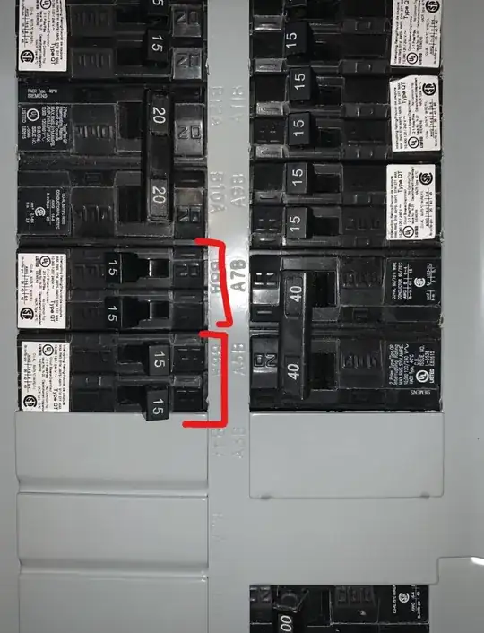

Per requests, here is an image of the breakers in the panel. Bottom left 2 groups. I currently have one off as they aren't hooked up.

  • Please upload a picture of the breaker panel. You could have anything from pairs of breakers that are perfectly good except that they should have handle ties to pairs that are on different poles (but not side-by-side) to pairs on the same poles (really bad) to double-stuff done right (really bad) to quadplex using the middle pair (good, except need to be handle-tied). **A picture is worth 10^3 words.** – manassehkatz-Moving 2 Codidact Aug 10 '20 at 14:59

This is totally wrong. You have 2 pairs of 1/2-size breakers - a.k.a., "double stuff" or "tandem". If you measure voltage between black and red (i.e., between a pair of hots) you will find 0V instead of 240V. If this was done by an actual licensed electrician, he should have his license revoked. If it was done by a handyman-acting-as-electrician, this is why most places don't allow that.
Note that this would be perfectly fine with two separate cables - i.e., each breaker getting its own black & white wires. But sharing (MWBC) only works if the pair of breakers are (a) on opposite poles/legs so that you get 240V between the hots and (b) the breakers are physically paired (handle tie or double-breaker) like the 40A pair across from these breakers.
And now for the really crazy part. The usual reason to go for 1/2 size breakers is because you don't have enough space to put full size breakers. But you have more space right below above (picture is upside down, or panel is upside down) the new breakers! You could easily have 2 pairs (i.e., 2 double breakers) of 15A full-size breakers and everything would be just fine.
There is actually one other alternative. A quadplex breaker:
QT 15A Quadplex
The beauty of a quadplex is that the inner and outer pairs each function like a traditional double breaker. Red and black to the outer breakers + white neutral. Red and black to the inner breakers + white neutral. Done.
Difference in cost between 1 quadplex and 2 tandem breakers at Home Depot? Less than $11. Probably even less of a difference at an electrical supply house.

Edit to add: Per your picture, without the deep knowledge of how your panel works that some of our members have ingrained, I think you have a serious problem here (and it's evidently not even done that way because of no spaces left, which would still be wrong.) I'm dead serious about reporting this to the licensing board(s). Both the electrician and inspector are at fault for allowing this.
  • Thanks, everything I've wired, and will wire, will share neutral. The breakers are separate, or per the link with diagrams shared by iserhwood in the comments, the breakers appear to be duplex, not 2-pole or tied. I can flip off red or black independent of the other at the panel. – KHibma Aug 10 '20 at 13:21
    You're saying you have 4 individual breakers feeding these two MWBCs and you can flip off any one of the 4 individually? That's a screaming code violation in this day and age - your electrician should know better, and the licensing board that licensed them would be fascinated to hear of this. Edit your post to add pictures, please, if you can. The situation that gives rise to is someone finds and shuts off "the" breaker serving an outlet, pulls open the box and proceeds to get shocked by the other side of the outlet because they did not know that this was an MWBC and the other breaker is on. – Ecnerwal Aug 10 '20 at 13:32
  • Yes, 4 breakers. Is there anything I can do with a multimeter to confirm the load (my original 30amp on neutral concern)? Or is the "only major concern" right now the issue of flipping off a circuit and the other is still live. Is an "easy fix" getting a 2 pole breaker and swapping that in? – KHibma Aug 10 '20 at 13:47
    With a multimeter, confirm the voltage between red and black is approximately 240V (correct) not approximately 0V (incorrect.) If you paid this person and permits/inspections happened, there are some real holes in your local system that need to be plugged, and you should not be stuck fixing this yourself - the electrican should (at no additional cost to you) come make it right, and the inspector and electrician should both be hauled up before their respective licensing boards. – Ecnerwal Aug 10 '20 at 13:51
