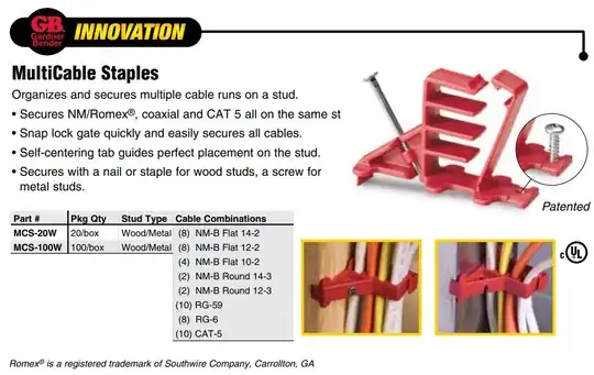

Would much appreciate your input on whether -
  1. It's NEC 2017 approved to use the below (or similar) multi cable staple when securing NM cable within 12" of the service panel, by attaching the cable staple to the back board and putting the cables into the staple. I.e.: Can I just use that staple before routing the cable to the joists above instead of the typical white plastic staples that can usually only do 1 to 2 12/2 cables? Id just cut off that little piece that usually goes around the 2x4 so it's flat against the back board, and use both the nail and the screw. If not, and there is no way to secure the cables within 12" above the panel, what else do folks use to the side of it to staple many cables to the back board?

Those multi cable clamps are listed so they can be used I have used the 2 slot 4 cable a few times without issues from inspectors, the only issue with more than 4 they may call it bundling but the listing info shows 8 so it should be ok.
