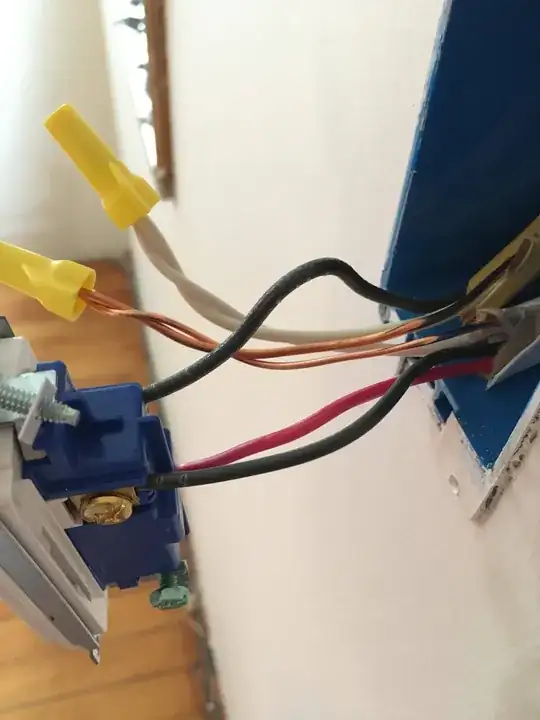

Here are some photos of the actual wiring:
Switch 1 -- the three-way switch is on the left, the other is a single-pole switch supplying another light. They're both connected to the supply power.
Switch 2 -- 4-way switch enter image description here enter image description here enter image description here
Switch 3 -- last 3-way switch (connected to light) enter image description here enter image description here

  • You *think* you wired it like the diagram. But something, somewhere, is different. Which happens to the best of us. Please upload pictures of the wires going into each switch. Try to focus the pictures (or make two of each box - switch & back of box) so that we can see how the cables are arranged. – manassehkatz-Moving 2 Codidact Aug 13 '20 at 14:40
    One thing to know is that the screws aren't always in the same position across brands. Be sure you know how to identify them by function. – isherwood Aug 13 '20 at 14:41
    @manassehkatz-Moving2Codidact I added the photos. – Sarah Aug 13 '20 at 15:30
  • @isherwood I can identify the common screws, but I might have missed something about matching up the different travelers. I've got the supply power correctly wired to the first black screw, and the output power correctly wired to the final black screw. For the travelers, I wired the travelers to "either" brass screw of switch 1. For switch 2, I put the inputs on "either' side of the input screws (the two top) and the outputs on "either" side of the output screws (the two bottom). For switch 3, I wired the travelers to "either" brass again. Could the travelers be mis-wired? – Sarah Aug 13 '20 at 15:32
