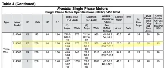

It's 1/2 horsepower on a 240v circuit. It's a Webtrol WS1005L with a Franklin Electric motor. Per the manufacturer's documentation, it draws a max of 6 amps on the two wires with a maximum load of 960 watts and only needs a 15 amp breaker.
manufacturer specifications

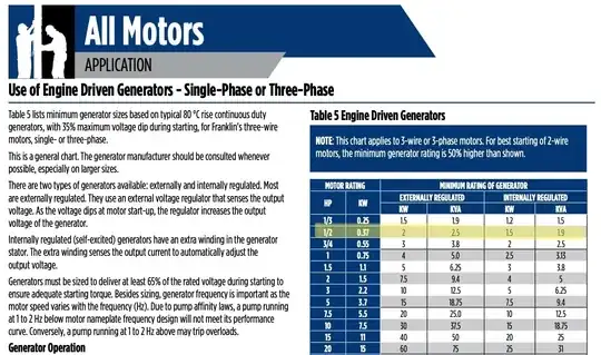

The manufacturer also says it can be run with a 2000 watt generator.
generator specifications

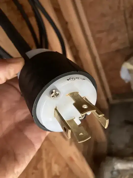

It has a beefy wire with a four-prong plug.
four prong plug

For the inverter... I can't find an inverter that has an outlet like that. Is there one? Do those funky looking universal outlets work for that? Can I use an adapter to get to a more "normal" plug?

  • that looks bigger than a 15 amp, there should be some numbers like L15-20 or L14-20 possibly 30 but it looks bigger than a 15a. I would guess it is a 30 amp plug , the correct plug should be used is there an inverter? I have seen the wrong twist lock used the numbers will tell. As far as batteries it depends on what solar voltage you want to set up. But to give them an idea 10 series batteries would provide 120v you need 240 plus losses and you really can not discharge the batteries beyond 50% so you can see you are rapidly running out of power with 10 batteries 4 hrs ballpark fully charged – Ed Beal Aug 13 '20 at 21:16
  • How many wires from the pump to the plug I also mentioned the plug type in the comments if you have 3 wire control with a ground going to the pump you may have start run caps and are using all the wires that’s why I mentioned the 3 phase plug if this method is used that is the proper plug not the L14- not in both cases the 30 a would not meet code. – Ed Beal Aug 13 '20 at 22:03

There are a lot of questions in your question, I'll answer the one relating to the plug. That looks like a L14-30 type plug (L14-30P is the plug, L14-30R is the receptacle). They are a locking type plug (locked by twisting).
These are pretty common on generators. If you can't find an inverter with this type of receptacle, you can easily source either a premade adapter or make your own - there are cord ends available at most home improvement stores or online.
But as Ed Beal pointed out in his comment, this does not seem to be the correct plug for the amperage of your pump anyway. You should switch it out for one that matches the current draw of your pump and the breaker that protects this circuit. The details for the rules on this can be found in the answers to this question.

  • Thanks! For the plug, I guess my question was more basic. I have seen adapters that will convert it to the three-prong style and a normal household 15-amp style plug. Is that OK as long as the wire is thick enough? I don't want to plug positive into neutral or something like that. – Andrew Kvochick Aug 13 '20 at 21:04
    No, I saw that one too and that is not acceptable to use. You need a NEMA 14-30P to L14-30R adapter, such as this one (just happens to be the first one I found, not a specific recommendation): https://www.homedepot.com/p/Conntek-14-30P-Dryer-Plug-to-L14-30R-Locking-Female-Connector-30-Amp-125-250-Volt-Pigtail-Adapter-14330/308998881 – PhilippNagel Aug 13 '20 at 21:14
    Actually a 30 amp on a 6 amp pump is a code violation. – Ed Beal Aug 13 '20 at 22:04
  • Even though that is what the pump has from the factory? Or maybe we shouldn't assume this plug was factory installed. – PhilippNagel Aug 14 '20 at 01:18
  • It did not come from the factory. I asked an electrician to put a plug on it, and that’s what I got. What is the correct plug @EdBeal ? – Andrew Kvochick Aug 14 '20 at 11:42
