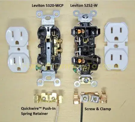

If I understand correctly, "backstabbed" receptacles are such that:
  • Have holes in the wall-facing side,
  • into which you push a wire, and
  • the wire is held by the pressure of metal plate pushing against it - a bit like a spring.
You may also find them referred to as "back-wire" or "quick-wire" receptacles.
important: "backstabbed" receptables are notorious for low reliability, and specifically, the tendency to overheat, arc and melt. Many suggest avoiding or replacing them.
Illustration of how such holes may look like from the back:
and here is a comparison between a clamping-based (on the right) and a "back-stab" mechanism (on the left):

  • How about the style of outlets where the cables go in the back but are clamped down using screws on the sides? It might be helpful to the OP to show an example of these too since they are not the same thing as the dangerous spring-style backstabs shown above. – supertanker13 Aug 16 '20 at 17:37

    @JimStewart It depends entirely on the specific outlet. The 5252-W in the image above is a $8-10 industrial grade outlet that accomodates up to #10 AWG in side and back wire configurations (not sure about Al on these specifically). The higher grade outlets like these often now also use the back-clamping connectors in place of the unreliable spring style 'backstab' connectors (which are typically #14 Cu only) - the back clamping connectors are completely reliable. – J... Aug 17 '20 at 13:58
