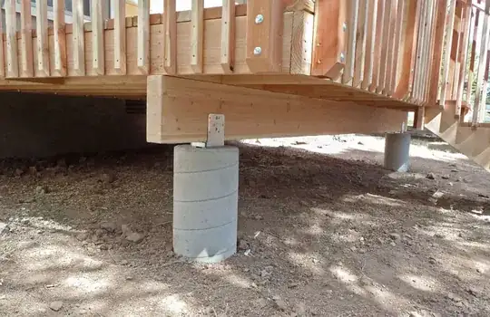

If you don't like posts in concrete (in my area there's enough water that these are problematic) I'd recommend looking at piers to replace the posts. These are concrete cylinders that the entire deck framing rests upon.

  • If the shale is solid (seems doubtful from some of what you have said so far) just scrape off the topsoil, drill anchor holes in the solid rock, insert rebar into holes, set your form tubes, and pour short concrete columns on top of and solidly connected to the solid rock. If it's not solid, you'll have to dig it to get a foundation you can trust. – Ecnerwal Aug 21 '20 at 12:23
