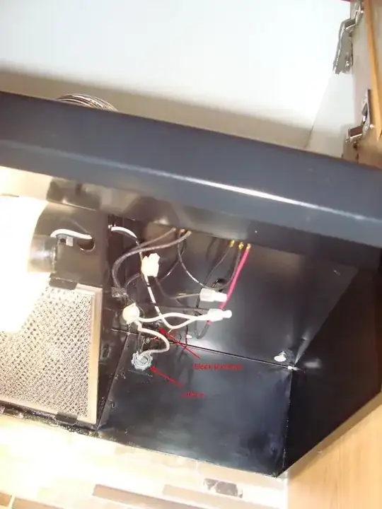

The power for the hood comes in from the wall:
wiring inside vent hood
Can I run a piece of BX or conduit up to a surface mount box secured to the back of the cabinet? Is it legal to use the vent hood as a junction box (note there's normally a metal cover over those wires)? Any better suggestions?

BX worked fine. I cut out a big hole because I needed room to be able to put the hood in place with the BX connected, and I left a big loop so there is room to pull the hood down a bit before disconnecting the wire.

    The range hood is already used as a junction box. You don't want to jam too many wires in there, make sure you do your fill calculations. – Tester101 Oct 25 '12 at 12:14
I'd use the range hood box as a junction box. It meets the code definition of accessible:
Capable of being removed or exposed without damaging the building structure or finish or not permanently closed in by the structure or finish of the building.
And in most places should pass just fine. I'd use BX because that MDF hood cover is rather easily removable, and treat the wiring to the new outlet as 'exposed'.
