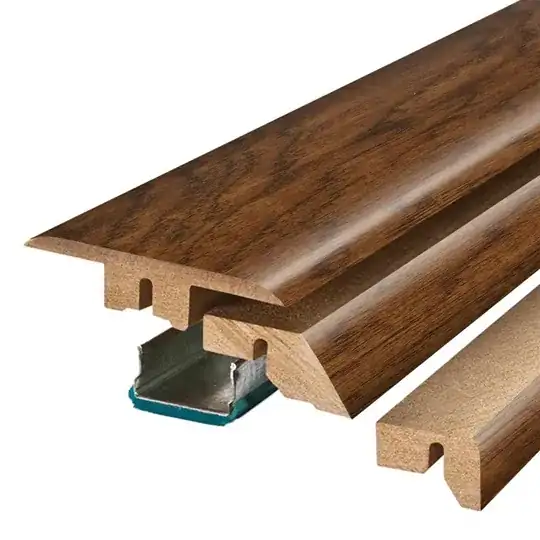

I think the solution can be even easier. Most hardware stores will carry uneven transition pieces. They're almost always wood and often are available in a variety of colored stains to match the wood floor. They are beveled in the front, so you don't have any tripping hazard, and they can be easily negotiated by wheeled devices (walkers, etc)
You'll probably want to put some wood between this and the tile (it won't bridge a 4" gap) but if you construction adhesive the wood and the transition down in the gap it should work just fine (make sure your adhesive works with metal if you choose not to screw/nail it down).
Uneven transition piece
    This could be the easiest / most practical approach. The only downside is that the transition ends up even a little bit higher than the adjacent flooring; but this might be perfectly acceptable if it gets the job done. – StayOnTarget Sep 01 '20 at 14:55
  • Clicking through to the installation instructions is useful too, because that particular product actually has several different configurations - not all the wood pieces necessarily are needed. So its simpler than it seems in the image. I know this product was just an example, however, – StayOnTarget Sep 01 '20 at 14:56
    The area needing transitioning is 21 feet long. – Kris Sep 01 '20 at 16:53
    Wouldn't be the first time such transitions were butt-spliced. – isherwood Sep 01 '20 at 17:09
