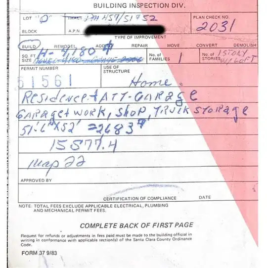

So, seller agent sent me this permit back from 1985, which I believe was issued at the time main house was built. He claims that this permit proves that 990 sqft guest house is permitted, because
  1. "residence" in "residence+att garage" in his opinion refers to guest house and not to the main home.
  2. seller claims that bathroom in ADU shows up on blueprints. And there would not be sole bathroom without guesthouse.
mit
However, I am still unconvinced that guest house was introduced under this permit, because:
  1. "residence" on this permit could actually still refer to the main home.
  2. assessor does not have any information about this guest house at all.
  3. it feels strange that guest house was introduced together with the main house but assessor did not know anything about living area beyond the 4,180 sqft.
  4. if guest house is permitted then on this permit I expected to see number ~990 sq ft. OR
  5. if I would subtract garage size (1,976 sqft as per assessor) from what I believe is the total ADU size (2,683 sqft), then I am left with only 707 sqft. So how could 990 sqft guest house be squeezed in a 707 sqft area?
How can I make sure that guest house is permitted? Does this permit in any way prove whether guest house was built with permit?
Update #1: Saw blueprints and it clearly shows that what they call as "Guest house" is actually labeled as "Work shop". If my understanding is correct, then Workshop does not count towards "legal livable area", but yet they still included it.

    Perhaps I'm reading it wrong but I don't see anything about an ADU listed on the permit. There seem to be two parts, "Residence + ATT Garage" and "Garage + Work, Shop, Truck Storage". I'd interpret that as a detached garage, not a dwelling unit. That part may have been converted into a dwelling unit at some later time but this permit doesn't show it. So that conversion and use is likely unpermitted. You might consult with a lawyer familiar with real estate before you spend your money. – jwh20 Sep 01 '20 at 09:56

Very easy to resolve. Have seller put in writing that the ADU was legally permitted when built. He has put you on notice with "seller is 'convinced' that it was legally built." If you accept that statement, you are making the purchase "as is" based on what he believes, not factual evidence.
Only if he puts it in writing that the ADU is legally built would he bear responsibility for misleading you if you later have an issue with the "ADU".
Ways to validate if ADU was built with a permit.
Go to the planning department and request a copy of the blueprint. The permits would not have been issued without the drawings. Also seller, claims the ADU is on the plan, so ask the seller for the plan showing the ADU.
Edited based on additional information:
The "guest house" was originally built as a "workshop". Later converted into livable space, “ADU”, conversion most likely done without a permit. So your underlying questions has been answer.
Per your added comment, “If my understanding is correct, then Workshop does not count towards "legal livable area", but yet they still included it.”.
I do not believe there is a California law that regulates how a home's square footage must be calculated. Livable space needs to meet certain requirements, i.e., heat, ceiling height, etc.”, The bottom line is you are purchasing the “ADU” feature “As Is”. Whether you believe the seller should include it as part of the "livable" space is your opinion. Even if the seller removes the footage as part of the livable space, the price would still be the same.

  • Indeed blueprint is the document to prove legality of "guest house". I just saw it and it clearly indicates that what they call as "guest house" is actually "work shop". I believe "Work Shop" should not count towards listing's "legal livable area" even if it visually appears like a bedroom with kitchen and bathroom.... – user2138912 Sep 02 '20 at 02:58
