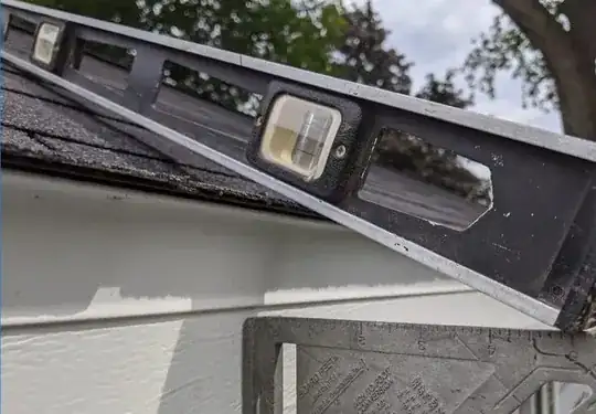

Here is the structure I have:
  • Roof pitch is 6/12
  • Aluminum drip edge overlaps fascia about 1.5"
  • Adhesive ice/water barrier installed over drip edge
  • Asphalt shingles overlap drip edge by 1/2", giving total of 1" overlap from fascia
  • 2x6 subfascia board with aluminum fascia cover
  • Total gutter run will be 22'
  • Structure is in Wisconsin, USA (cold, snowy winters), and will be insulated and (moderately) heated.
Roof edge showing overhang
Roof edge showing pitch and extension

If your drip edge (and the shingle protrusion) are working properly, water will fall from that outermost point. Obviously this means that the gutter shouldn't need to slip behind the drip edge flange. In fact, in cases where the run is long and the slope requires enough drop, this isn't possible anyway without additional flashing. That's not usually necessary, especially with newer construction and a 6:12 pitch.
Start at the high end of each run with the gutter just below the drip edge flange. Slope down from there. Nothing should penetrate or result in modification of the drip edge.
You want the gutters about right where the ruler is, maybe a smidge higher.
When you install your gutters you can caulk the back. However I have never done this as it is an exercise in futility. If you can caulk the back the water will go to the failure point and honestly who wants to check and caulk their gutters continuously - this may be a yearly exercise. Doable? Yes. Works? Yes. Time spent well? No.
What you want to do is after you install your gutters is pull the drip edges out. They should not be flat against the fascia like your picture. Yes you have a good install right now but when gutters are put up you need to pull them out a bit. This is especially true in colder climates that have drips and ice. With your drip edge flat you will surely get ice dams behind the gutter - yes I know very slim ones but still.
Yes I know most fascia boards are made out of wood anymore. If yours is, these dams will speed up the rotting especially after a few seasons of the paint breaking down. Even with a pvc board these ice dams do damage too because the pull the screws out of the gutter. Just pulled out a bit your gutter weight (when snow or rain hits) will cause it to droop over time.
Generally I like to see the drip edge about a 1/2" out at the bottom. You do not need spacers for these as they would have to be fastened and I don't like that idea.
For the screws, you can caulk them but this generally is a low risk area of the gutter. If your screws are tight (and given they are towards the top of gutter), there is very little risk that water pools behind them compared to the water dripping down behind the gutter from the fascia.
