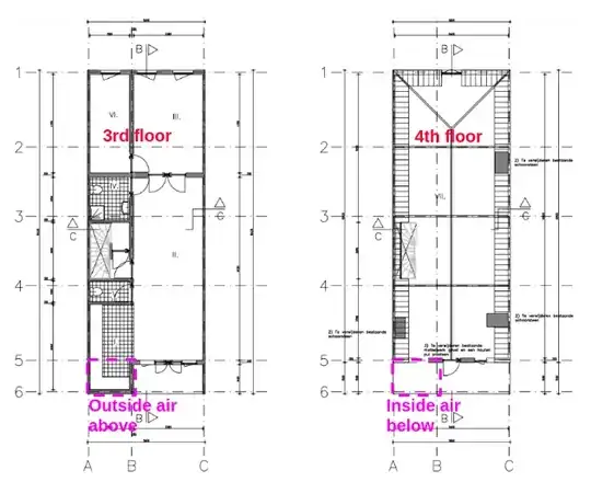

I'm renovating the 4th and top floor of a house built in 1906 in Rotterdam, the Netherlands. The house has masonry load-bearing walls and wooden beams. The current situation is shown in the image below. enter image description here
The area in pink has the building envelope as shown in the B-B section cut below somewhere between grid lines 5 and 6. Note: This space currently is not insulated.

A glass facade will be installed 1 meter behind the location of the existing masonry wall thus creating a balcony that is 1 meter longer than it is currently. This is shown in the proposed floor plan below.
