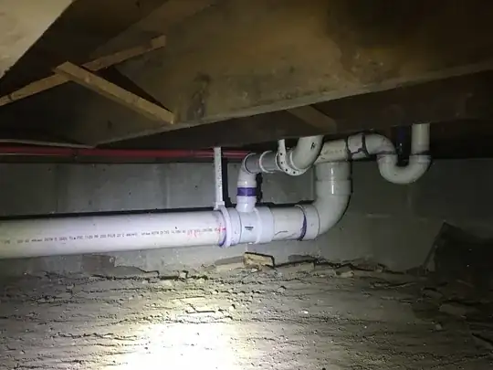

I have been in the house for about a year and the toilet has always had poor drainage. It doesn't overflow but there's hardly any suction at all when you flush it. The tub next to the toilet drains very slowly and will gradually fill up when using the faucet but just running the shower head it drains fast enough to keep up. Both are tied to the same drain line and I figure maybe there's a blockage somewhere. Btw, I replaced the toilet a few weeks ago and it made no difference. (reasons other than just drainage)
I had a plumber come out and they think that the venting was done improperly. The pipe on the left coming off the T is the vent and goes straight up through the roof. To the right, tying in just in front of the vent, goes to the bathtub.
I was quoted at $1200 plus materials to rearrange this. I'd prefer to keep that money in my pocket to fix other things and have no problem crawling in there myself to do the work. I'm just not sure exactly what their plan was to correct the placement of the pipes.
Here's what they wrote on the invoice:
Remove a section of the four inch main drain line into the crawl space area and tie in the drain and the vent line separately so that it is no longer wet vented and. This conclusion was found due to having the customer flush the toilet while I was on the roof to see what/ if any air was pushed through and it was minimal.

    I don't have enough plumbing system design experience to answer with confidence, but this is a "wet vent" scenario. Unless your tub is actively draining when you flush it shouldn't be an issue. There's plenty of venting available there even if it isn't ideal or strictly legal. Have you checked that the vent is actually clear all the way through the roof? – isherwood Sep 23 '20 at 18:33
  • And what did your local plumber propose as a solution? – isherwood Sep 23 '20 at 18:34
  • I'm not sure of his exact solution, but basically wanted to move where things interconnect. I think remove the tub drain from the vent and move it further down the main pipe, he didn't get into specific detail on how he was going to change it. – Phaelax z Sep 23 '20 at 18:40
  • It’s hard to tell from 1 photo , how much drop and slope you have – Tony Stewart EE75 Sep 23 '20 at 18:42
    I agree with Isherwood not a plumber but that vent is close enough where it should not be an issue when you flush the toilet is it sucking air through the tub drain if it is there may be a blockage in the vent line itself, I have found leaves a culprit several times in a 4” old home I even found a dead squirrel it doesn’t take a lot to block vents I would run a snake or garden hose down the vent from the roof. – Ed Beal Sep 23 '20 at 18:42
  • I've updated the original post under the pic with what was written on the estimate. – Phaelax z Sep 23 '20 at 18:43
    Have someone drop some ice cubes into the vent while you listen for them to arrive in the crawl space. You'll know in a hurry if the vent is clear. – isherwood Sep 23 '20 at 18:47
  • Is the tub & vent 1.5" or 2" ? The vent (at least) should be 2" (since it's venting a 4" pipe, according to the plumber's estimate.) – Ecnerwal Sep 23 '20 at 19:34
    get under threre and slap that pipe to see if it's full of water – Jasen Sep 24 '20 at 08:37
    Stupid question: Did the plumber snake out the drain? – Hot Licks Sep 24 '20 at 22:18
  • @HotLicks Already answered in comments below - No, they did not. – Ecnerwal Sep 25 '20 at 12:55
  • I agree with the commentors & posters suggesting your company is not the best. First step would be to try snaking/rodding the drains with or without camera; you can try this yourself with a cheap solution, or ask a specialist or (competent) plumber. – user3445853 Sep 25 '20 at 15:09

Unless something is clogged, this should work fine (assuming appropriate slope on all lines.) The vent should be 2" for a 4" line, and is only draining the tub (2DFUs) which is half the permitted load wet venting. The vent loading (shown) anyway) is at most 8 DFUs (depending on toilet flush size) and while that could (easily) use 1.5" on that basis, it can't wet vent more than 1 DFU at that size and it's also not "at least half the size of the drain pipe" so it would be undersized/illegal. There is an error which your plumber failed to mention, however.
When you are not showering or draining the tub, that is a dry vent (yes, it's technically a wet vent all the time, but in practice, it's dry except when the tub drain is flowing water.)
If you (or plumber) have not already snaked the tub drain all the way to the main line, do that. Snaking the vent is also advisable, as it may be clogged away from the tub connection or on it's way to the roof. Snaking the main line to whatever point it appears to work well is also advisable. Unless something was done that you/your plumber did not mention, I see no sign that it was actually checked to be clear in what you have reported - just that the plumber stood on the roof and observed it not working.
The thing that is VERY wrong with it (not mentioned in your quote) is that a sanitary TEE is being used incorrectly to join a horizontal drain - that should be a WYE, and if you are replumbing, you'll want to fix that. You can use a "combo WYE" or a "WYE and a 45" in that orientation, or you can use a wye in the normal (to the side) orientation for the drain connection.
Under IPC rules it's generally accepted (or not forbidden) to use a sanitary TEE that way FOR A DRY VENT ONLY. Some dispute that use being acceptable, and other codes may actually prohibit that use - IPC prohibits that use for a drain or wet vent connection. A WYE is always acceptable - for a dry vent, pull the WYE up to at least 45 degrees above centerline, or run it right out the top.
If you wanted to change this around and separate the functions as proposed (which I doubt will help, unless one of the pipes you cut and replace is full of gook that you should have gotten clear via snaking) you're in for a signficant bit of work - dropping a new fitting into a main line means getting upwards of two inches of motion on it, and under IPC rules "saddle tees" are illicit (don't know what rules you are under, code-wise) though you can use PVC repair couplings (and pray they don't stick before they are in the right place) or rubber couplings to have a "removable section" to give you the working room. Here you might just yank the toilet and unscrew its flange to get the working space you need.
The other distinct possibility is that the main line is not properly sloped all the way to wherever it goes off to the left side of the picture - a low (or high) spot in the line can cause all sorts of trouble with proper drainage. A competent plumber should have noticed that, but I question your plumber's competence (or perhaps honesty) if everything did not get verified as clear by some means (snake, drain camera, whatever...)
If seeking to "separate the functions" (or simply make it "correct to code", at least IPC) the most minimally invasive method I would envision is (after thorough pipe cleaning):
Cut off (leave stubs) the tub trap. Under IPC rules the distance from the fixture outlet to the trap weir "cannot exceed 24 inches" vertically, which means you can be that far, if needed. Extend the tub drain down to reposition its trap weir (the waterline in the trap) 1/4" per foot it's away from the main line higher than the centerline of the main line where you will connect it. It looks like you probably can do that within 24" vertically of the tub, by eyeball. You're looking to run it under the vent line, which you will leave alone other than throughly cleaning it.
Cut in a 4x2x4 WYE (i.e. a 2" sidearm from the 4" line) rolled just enough above centerline to meet that trap (ie, rather than set the WYE dead level, set it so that it connects at the right slope for the drain.) Connect a 2x2x2 (or 2x1.5x2 if the tub is 1.5") WYE "more than 4 pipe diameters downstream" (8" for 2" pipe) from the trap exit on the new drain line and plumb that to the (now dry-vent only) former tub entry to the dry vent line - that vents the tub trap directly, since you have the connection sitting there. Wet venting it via the main line back to the dry vent is likely acceptable, but this is better, and costs very little in time, effort, or parts.

    He did not attempt to snake anything, which I figured would be the first thing he'd do. No camera, he wanted to but did not have one. He's not a "drain guy", and only they get cameras at their job. I'm not sure what separates a drain guy from a plumber, but this is fairly large plumbing company in the area. I'm also almost 45min outside a major city in a corn field, not many will drive out here. I'll get a snake and attempt that first and see what happens. – Phaelax z Sep 23 '20 at 19:51
    So you had **a drain problem** a 45 minute drive from the shop and they sent you "not a drain guy" - spread the bad word of mouth far and wide, that's a **lousy** company. – Ecnerwal Sep 23 '20 at 20:34
  • Maybe I haven't had enough coffee yet this morning, but I'm having a really hard time following your descriptions of the issue and the suggested repair. Would you consider a little MS Paint on the OPs picture to show the problems you've identified and the proposed fix? I'm not doubting you, just not following you... – FreeMan Sep 24 '20 at 11:53
    I would never consider using MS Paint. I've hated MS since DOS was cutting edge. ;-) And I haven't had enough coffee yet myself. 1000+8 words as requested. A Sanitary Tee is only acceptable for entering a VERTICAL pipe if it's carrying waste-water. This use is forbidden. Stuff piles up on the uphill side of the tee where it "plops" out of the tee with no impetus down the drain line, as it would get coming from a combo- Wye. – Ecnerwal Sep 24 '20 at 12:50
    Upvote for checking the fall on that horizontal line. OP should be able to check this themselves with a level. – alexw Sep 24 '20 at 18:53
  • I ran a 25' drain auger, didn't seem to have any issues, but also dumped a gallon of "Instant Power Main Line Cleaner". Wasn't sure if its safe to put that down the toilet, so I poured half through the shower drain and half down the vent pipe. After a few hours, didn't seem to make any difference. If there is a clog, I can't find it. I'll check the slop of the drain pipe next. – Phaelax z Sep 25 '20 at 17:28
  • Have you snaked everything (tub, vent, and main), or only the main line? – Ecnerwal Sep 25 '20 at 18:18
Run some water in the tub until the problem shows, then get under there and slap that pipe to see if it's full of water it should be mostly empty and sound hollow.
If it's full there's a blockage downstream somewhere.

I see that nobody has bothered asking about the performance of your septic system. Do you have a gravity system, or do you have a lift pump? If you have a lift pump, that means there is a filter inside one of your main septic tanks, that is supposed to only permit grey water to pass through a horizontal pipe leading from your main septic tank to the smaller (typically 300 gal) lift station tank. At my place, that filter can get gunked up with long hair, just like a shower drain, and this leads to very slow flow of water from an overfilled main tank to the 300 gal lift station tank. This gets to a point where my downstairs toilet and tub drains too slow. If left unmaintained long enough, grey water will backup up into the downstairs shower.
Also, a friend of mine bought an older home, and the previous owner was in the practice of pouring bacon grease down the drain for years. Over time, this had the same effect as cholesterol in your arteries - the size of the 4 inch (gravity system) drain pipe going into the first septic tank shrank to about 2 inches before the new owner finally had a plumber out to his house that actually found the root cause for his slow-draining system. You could pour all kinds of liquid acids into his system, and would not have penetrated deeply enough, because by the time the acid reaches the blockage, it is too diluted. The fix estimates were crazy. He fixed it himself by digging down the side of his foundation wall to the pipe, and digging all of that out enough to go about cutting out a section of it to clean it all up and then ended up replacing that 4 inch pipe between the house and tank. A dirty, nasty time consuming job indeed which is why the estimate was so high. My point is, before you go about replacing pipes and rerouting, be sure that the real issue is not with the tanks and final lines. Prove that you have really good drain volume at another tub in the house first. It could take dumping 2 or 3 5-gal buckets of water into the pipe as fast as you can to discover if the problem is just an "almost full" tank, or clogged septic system filter.
Darrin
  • 121
    I should provide the disclaimer; do NOT cut into your septic line pipes unless you have had all of your septic tanks emptied to a point that is below the inlet hole inside the tank. If you don't you'll of course find yourself in a pond full of doodoo. ;-) – Darrin Sep 24 '20 at 17:01
    This is useful information, _assuming_ the OP is on a septic system, not city sewer... – FreeMan Sep 24 '20 at 18:10
    Did say "middle of a cornfield" which trends septic, but did not mention a problem affecting **all the house** or backing up out the lowest drain (so appealing, not.) Which makes this less likely to be the root cause.... – Ecnerwal Sep 24 '20 at 18:58
    No septic, city sewage. Only 1 bathroom. Only the tub faucet and the toilet seem to create more water than the drain can handle. – Phaelax z Sep 24 '20 at 21:40
  • So, the clog is between the toilet/tub and the next thing on the line, (bathroom sink or whatever comes in next) evidently. – Ecnerwal Sep 25 '20 at 12:53
  • If snaking out everything still does not improve the situation, I would next have a good look at the trap installed onto the tub--not the PVC trap in the photo. It could just be fastened at an angle that is level or negatively sloped due to the spacing--such as being too close to a floor joist to make an ideal connection to the tub. The sink might be tied into the vertical PVC pipe in the wall (we can't see it here to know). – Darrin Oct 02 '20 at 18:17
  • If those things look okay--and you will know when it doesn't look right--then I agree with extending the drop of the vertical drain pipe of the tub, by lowering that trap, and tying it into a [new] santi-wye as suggested by @Ecnerwal. Especially if the tub is sitting right there only inches above that trap in the photo, and the sink is also wye'd into the vertical tub drain pipe--all in a tight place, or in less than ideal structural arrangement. – Darrin Oct 02 '20 at 18:17
  • Didn't catch my comment in time to change "sink" to "toilet". – Darrin Oct 02 '20 at 18:46
