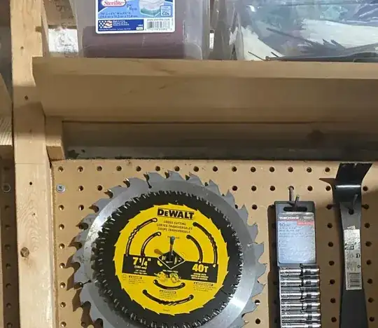

Yes, you can place pegboard between studs, but as you stated, you need some clearance behind the pegboard. You could use 1x1 attached to the side of the studs to screw into. This will give you better holding power than brackets alone.
When I did mine, I used 1x2, but I screwed them in across their width, so I'd have more surface area to screw to. My studs were not exactly spaced and straight so I needed a bit more area to attach.

    Pardon my ignorance, but by 1x1 are you referring to what would be carried under "dowels" at a store - or is it a separate type of dimensional lumber? Also, I would attach the 1x1 to the studs with screw, as well, yes (as opposed to just wood glue, for example)? – Sven3B Sep 23 '20 at 20:05
    Yes, the 1x1s would be in the dowel area or you could cut down 1x2. No glue – UnhandledExcepSean Sep 24 '20 at 13:40
