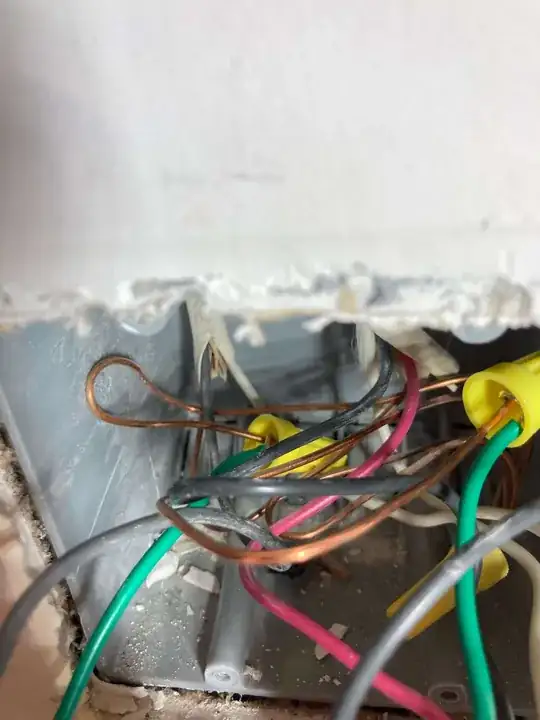

EDIT: adding two photos of the back of my junction box since some people asked. I know it's a little hard to see, but there are two bundles of cords entering from two ports at the top of the junction box. The bundle on the left has three wires: black, white, and unshielded copper. The bundle on the right has four wires: black, red, white, and unshielded copper. Before I installed my new smart switch, the two white (neutral) wires were connected together with a wirecap. Thank you for the help!

  • Can you post a photo looking into the back of the box please? I'm 95% sure you're right, but there is a 5% chance you are in a situation where Code prohibits this, and I can't rule that out without another photo – ThreePhaseEel Oct 05 '20 at 23:55
  • @ThreePhaseEel sorry, just saw this - I added two photos and a description of the junction box. I'm also just super curious about what this special situation is - would love to hear more! – HuntedC Oct 14 '20 at 21:06
  • You're cool, based on the photos (2 switches and thus 2 switched-hots, leaving only 1 way for always-hot to get in out of the 3 possible hot wires, so no chance for an issue). The situation where this'd be an issue is where a *multi-wire branch circuit* (2 hots on opposite legs sharing a neutral, thus "stacking" loads and letting folks economize on wire) is involved, because breaking the neutral unbalances the "stack", so we can't let removing a device do that under those circumstances – ThreePhaseEel Oct 15 '20 at 01:24

    Agreed never is a bit strong, except with the exception of where NEC 300.13(B) prohibits device connections where the removal of the device would interrupt continuity of a multi-wire branch circuit, which is a circuit where the neutral is used on multiple out of phase or opposing hot legs. We can't see if this situation exists in this j-box. – NoSparksPlease Oct 06 '20 at 00:09
  • @NoSparksPlease sorry, just saw this - I added two photos and a description of the junction box. I'm not sure how to tell if my neutral is used on multiple out of phase legs, so it would be awesome if you could let me know! – HuntedC Oct 14 '20 at 21:08
    @HuntedC To determine that, which I suspect is *not* the case here, check back at your breaker panel. If everything is installed properly (a big "if") then if a single breaker turns this circuit off then it is **not** an MWBC. If the breaker is part of a pair (two breakers with a handle connecting them) then it is an MWBC and the "don't break the neutral" issue applies. – manassehkatz-Moving 2 Codidact Oct 14 '20 at 21:17
    @HuntedC I still can't see completely, but it appears you have 2 blacks and 1 red, that seems like the only possibility is one hot, so there wouldn't be a 300.13 violation. – NoSparksPlease Oct 14 '20 at 23:45
