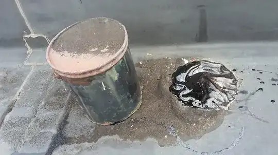

Here sat a broom and a can of tar roof patch. It had been used by amateurs 5-7 years prior, to patch the adjacent metal roof, and was forgotten. The drippage/leakage completely trashed the rubber. The rubber underneath where the can was, is pretty much liquified. Beyond, you can see rubber roof seams done properly.
