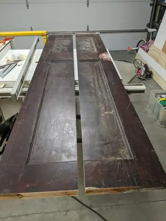

Needed a door that matches that the doors from 1940s in my house. So I bought a 30" door on Craigslist and cut it down to 23" by cutting out the middle of the door as you can see in the pictures.
I'm faced with two decisions that I would like some expert opinions on:
  1. My initial plan was to install a new panel, but now I'm wondering whether it's possible to join the two halves of the old panel. They are 5/16" (or 11/32"). Is that enough thickness for some kind of rabbet joining strategy?
  2. As far as joining the two halves of the door together, I have three strategies in mind:
    a. Glue them straight up
    b. Use dowels
    c. Drill the entire 23" width of the door in three places and use 1/4" all-thread.
What would you recommend? enter image description here enter image description here

    Do you have a joiner? You're doing to need something to make sure they fit together smoothly. Personally I wouldn't risk trying to glue together the two panels together. I'd also use dowels+glue. There seems to be several youtube videos of people making large barn doors from two doors, similar to your project. –  Oct 10 '20 at 06:27
    For the panels, I'd make a guess it'd be difficult to glue them together and not have the panels move because of thickness when you clamp it.. Plus a new pane is of course going to add strength to the door. –  Oct 10 '20 at 06:30
    Best method I saw was the 3 rails were separated from the upright, then shortened and the upright reglued back into position - best way to keep the structural integrity. – Solar Mike Oct 10 '20 at 09:36
    Rather than dowels, which are difficult to locate properly, you might consider a "biscuit jointer". These are relatively inexpensive these days and do a great not not only supporting the wood structurally but locate precisely. I don't think you'll be able to use them in the thin panels, however. I'd either replace those or just glue them. I think the important thing is to make sure the structural part of the door holds solidly. – jwh20 Oct 10 '20 at 11:01
    try using wood biscuits for joining the plywood ... https://duckduckgo.com/?q=wood+buiskit&iar=images – jsotola Oct 10 '20 at 17:43
  • Yep, biscuits.. – Hot Licks Oct 10 '20 at 21:39
    BTW your option 2c is flawed. You have no hope of drilling all the way through the two door halves and using threaded rod as a long bolt. The drill bit will wander and worst case may burst out the door's surface. You need a 12" bit to avoid trying to meet two blind holes in the middle, and the holes at the cut would have to be identical to avoid a lip. Crucially though, that's a lot of leverage on a tensioned bit of threaded rod, and any push in the middle of the door will bend the rod. – Criggie Oct 12 '20 at 11:08
  • You might consider adding a strip of decorative molding over the panel's joining seam. The door would appear to have four thin panels. I think the panels are too thin for your standard biscuit joiner. – Steve Wellens Oct 13 '20 at 04:32
  • Agreed with @SteveSether - this will be difficult, at best, and if you don't have a *jointer* (or a hand planer and half a lifetime of experience) you'll have no hope. Do you have a jointer? – J... Oct 13 '20 at 13:10

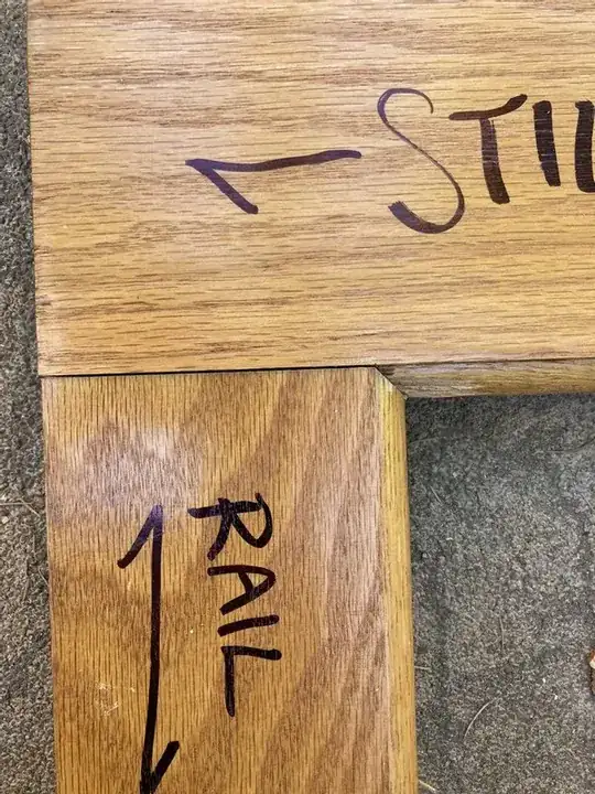

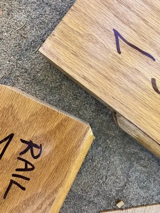

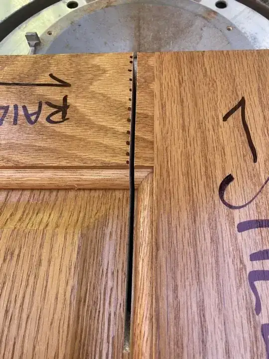

Here's a series of pics that show what I'm talking about above.
Starting point. Sorry about the rotation.
Rough cut the rail. Don't cut any of the molding on the stile.
Mark where the rail copes over the molding on the stile. You'll cut that part of the stile later.
The molding on the stile runs all the way through under the coped rail. Somehow, chip/cut away the remaining rail.
You can do part of it with a chopsaw (granted, awkward with an 82" stile and impossible for the midrail), but don't cut past your pencil line. You'll inevitably be left with some wood that the chopsaw won't touch, so chisel/ multitool/ whatever to clean that flat.
Cut the miter that you marked with the pencil earlier on the stile molding. (Don't do what I did and bust off some of the molding while demolishing the remainder of the rail.)
Cut the rail to width and miter the molding.
Your parts should go together perfectly. Join them as described above.
