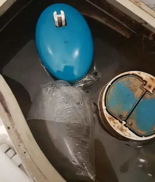

I had the same problem which caused a lot of frustration. I want to share a simple solution that worked for me. All you have to do is take a small plastic bag (small enough to fit your tank without impeding the other parts of flush mechanism). Fill the plastic bag with a little water (maybe 1/4 cup) + some volume of air, then tie up the bag. So the bag will be like a balloon with water and air inside; tie the plastic balloon on your float. The plastic balloon will float together with your float because of the air. but when the toilet is flushed, the water weight of the balloon will pull your float down, thus triggering the water filling action. This might take some trial and error with regards to the size of the bag and water to air ratio but this worked very well for me.
