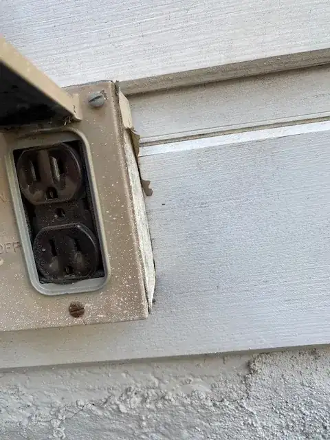

Here's the current outlet. I need to leave a cable connected constantly. Is there a snap-on cover for this type of thing? (Can I gaff tape a quart baggie over it?)

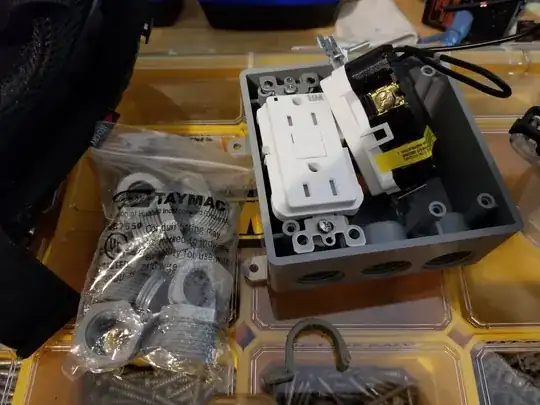

I think mark f has already answered your question well. I just wanted to add some photos from a similar project I did last year in case these are helpful to you.
I installed a weatherproof cover and box to replace the old ones that supplied my above-ground pool. Fair warning: don't do this at your own pool because my installation was deficient in several ways; but I bought the house with some problems already existing, and I just needed to make a repair and add GFCI for my own comfort; my city didn't care.
Anyway, first picture is what the box looked like with a couple duplex receptacles in it. Hopefully, you won't need a new box; but if you do, they come with plenty of plugs and conduit bushings. first picture

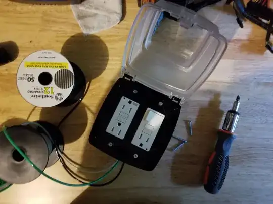

Then I have the parts that came with the cover; that's the cover itself plus a gasket that makes it watertight. weatherproof cover parts
Here's what the box looks like with the gasket fitted: gasket installed
And now with the cover attached using four mounting screws: cover attached
What it looks like when closed: enter image description here
Finished, with a cord plugged in: finished and cord plugged in
I hope this helps!

  • Thank you, so this would work with the existing box? I just switch out the front plate? Box is 4 3/4" square, 2.5" deep. – ttt Oct 13 '20 at 19:19
    Yes that is a standard 2 gang bell box and it would fit like a glove. I would advise to use a metal one as the plastic ones always get broken in my experience bell boxes or weatherproof come in 1 gang , 2 gang and 3 gang,,, you have s standard 2 gang. The boxes that have knockouts like the 4x4 called a 4-0 and 4-3/4 are not weatherproof. – Ed Beal Oct 13 '20 at 21:52
    go to your favorite hardware store, and find one with the proper box size they come in 4x4 and 4.25x4.25 and probably 4.75x4.75 also. you might want to pull the existing cover (with breaker off) and check the screw pattern for the cover too. And look for Ed's aluminum cover, you will likely be glad you did in a few years when the plastic one failed... – mark f Oct 13 '20 at 19:24
  • thank you - added a couple of pics of the box open, is that showing what you meant by checking the screw pattern? – ttt Oct 13 '20 at 19:41
