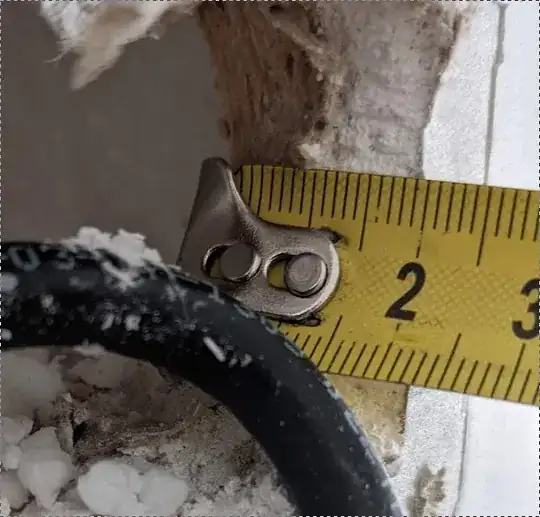

I used four spring toggles, as well as the four wood screws that were included with the brackets. Here are the spring toggles:
I made four 14 mm holes, then, to allow the spring toggles to expand behind the board, I scratched bits of insulation foam with a bent metal rod placed at the end of a drill:
After that, I inserted the spring toggles, pulled on their screws to expand them, then removed the screws. The spring toggles stayed in place, thanks to the insulation foam:
Then I attached the bracket. Basically, the four wood screws prevent the bracket from moving vertically; and the four spring toggles prevent the top of the bracket from being teared off the wall:
It has been like this for three weeks, and it hasn’t moved :-) Note that I keep the TV close to the wall; I only move it when I need to plug some wires.
