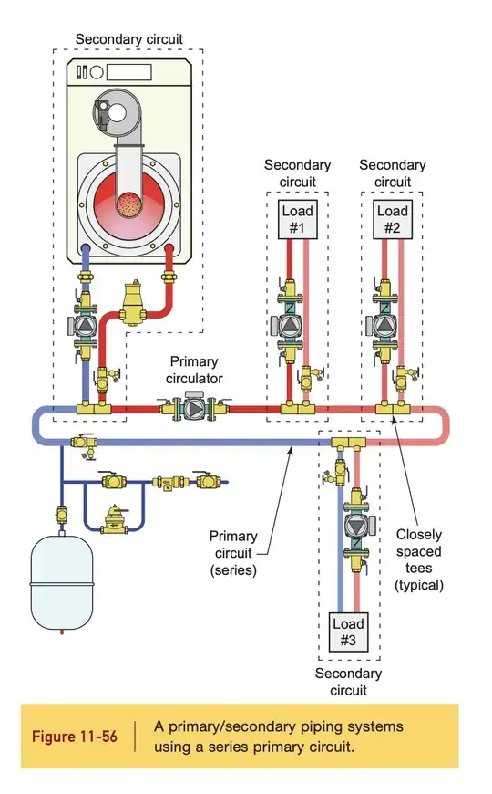

Based on this photo I would think that this is plumbed using monoflow (diverter) tees.
In a primary/secondary loop system the secondary loops need their own circulator but OP says the system only has one pump for all zones.
Since the "supply" side of the drop and the "return" side of the drop are consecutive (no other supplies between this supply leaving the trunk and returning to it), it also suggests that if this was a primary/secondary loop system then each secondary loop would need to be in series. This is an inferior design if all secondary loops are designed to operate at the same temperature.

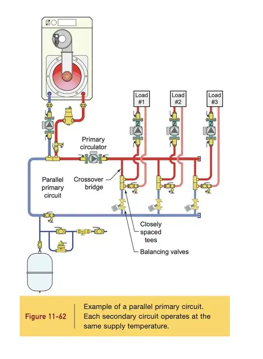

A better design is to plumb secondary loops that are supposed to operate at the same temperature in parallel:
Hence, you may be able to discern based on how evenly your system heats if this is how it is plumbed.
