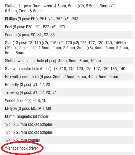

The list of bits in this set, lists it as a "Y-shape hook driver".
100 piece "security" bit set and plastic case screenshot of available bits highlighting Y-shaped driver
