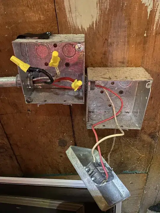

I was installing some new dimmers and outlets when I found two breakers were running in to an electrical box using a 3-wire conductor (red, black, white). Red/black were switched by different breakers, so they seemed to be sharing a neutral.
I've seen other threads (main one linked below) here that seem to indicate that this is OK as long as:
  1. The two circuits are on different "legs" of the 240v supply
  2. The two breakers are tied together.
I wasn't sure how to tell if the two breakers are on separate "legs". How do I tell if this is the case? I found two boxes with this configuration. the breakers associated with o[![ne box were adjacent to each other. While the breakers on the other box are separated by 1 breaker. Does this seem right?
The other issue that the breaker pairs can be turned on/off independently. This doesn't seem safe and I was pretty confused with my NCV detecting voltage with only 1 breaker off. Is this anything to worry about? I imagine the rest of the circuits in my house follow a similar pattern - 3 conductors sharing 2 breakers.
The house was built in 1981 (WA state fwiw) and I don't know the history behind the electrical work here.

    One way to check is to take a voltage meter and check the voltage across the legs, if it's double what from live to neutral then it's separate phases. – ratchet freak Oct 27 '20 at 09:00
    A pic of the breakers in the box would help immensely. Barring that, _generally speaking_, if the breakers are normal, full-size (not skinny, half-size "double-stuffs") and they're right next to each other in the box, they'll be on different legs. If there's space between them or on opposite sides of the box, all bets are off. See - providing a pic (and one of the box's label, so we know the make/model of the panel) will give the experts here concrete evidence instead of your/my guesswork. – FreeMan Oct 27 '20 at 11:38
    Yes, can you get us a photo of the breakers in the breaker box, and can you measure the voltage between the two legs? – ThreePhaseEel Oct 27 '20 at 11:44

  • Thanks everyone for your comments. I updated the post with pictures of the breakers and a picture of the box' label as well. – KZ. Oct 27 '20 at 17:48
  • @FreeMan I attached some pictures! – KZ. Oct 27 '20 at 18:03
