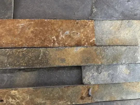

I'm redoing my shower from scratch and fell in love with the combination of this Slate Multicolor Porcelain Tile and Splitface Slate Panel Ledger:
I have limited experience with tiling and have several concerns with this combination, for which hopefully someone could steer me in the right direction.

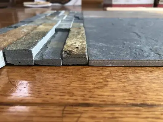

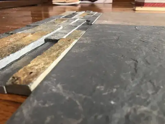

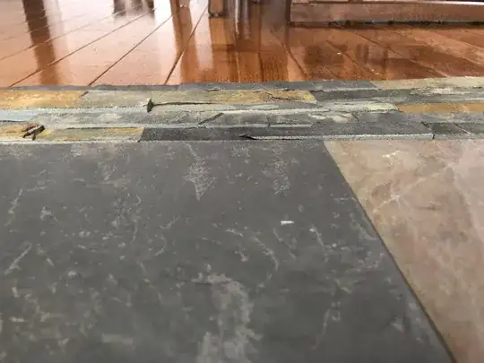

  2. Finishing: With the split face panel ledger being natural stone, the thickness varies from piece to piece from 1/4" to almost 3/4". In some places it will be flush with the porcelain and in some it will stick out. I'm not so concerned about this transition in particular, however is there any way to ensure a clean looking finished edge on an outside corner / drywall transition? enter image description here enter image description here enter image description here

  4. Grout & Sealing: The individual stones in the splitface panel ledger are either flush with each other or have tiny gaps between them - will it be possible and/or necessary to grout between them? On the backside there is some sort of glue between the individual stones, though I am not sure how waterproof that is.
