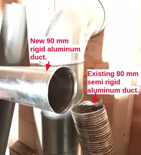

In a 4 story multi-owner house in Rotterdam, the Netherlands there is an 80mm semi-rigid aluminum duct like the one shown in the image below which contains the water heater exhaust of my neighbors who live below. Since I have made structural changes to the roof this duct needs to be extended. Ideally, it can connect with a rigid pipe that can then connect with the roof exhaust.
several aluminium / aluminum ducts, one coming in horizontally through the wall in the back, making a 90° turn downwards and leaving the image at the bottom; one marked "new 90 mm rigid aluminum duct" coming in horizontally from the left, open-ended; a flexible one coming in vertically from the bottom right, marked "existing 80mm semi rigid aluminum duct", open-ended
I cannot find a piece to provide a mechanical connection from this semi-rigid pipe to a rigid pipe. Do you have any suggestions?
