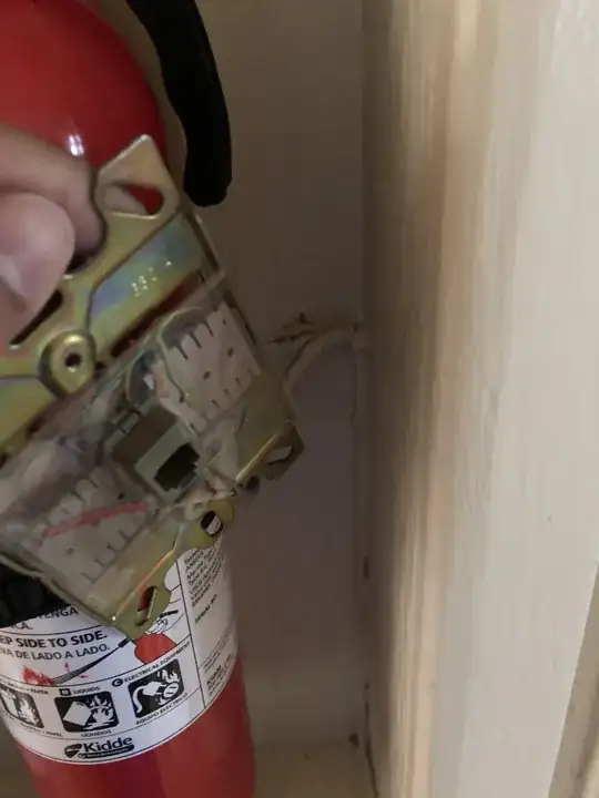

I'm in the process of removing an old telephone jack that has wiring running along the wall. The jack is easily removed, but I'm unclear on what to do with the wiring. It seems short sighted and foolish to just snip it off.
On the other hand, the wire seems to lead into the crawlspace below the house, and I'd rather not go under if I can avoid it.

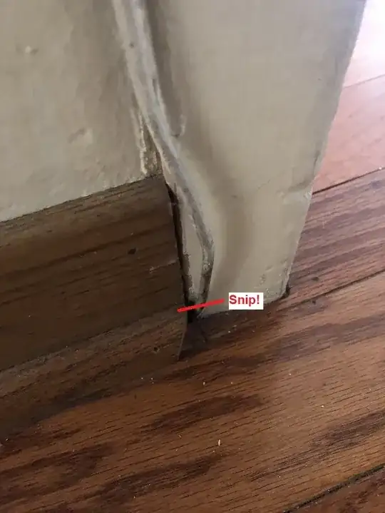

If you are removing it, remove it.
It's only "short-sighted" if you have any conception that you might want a landline phone there.
You MIGHT be able (depending on how snug it is, and how many layers of paint are on the cable making it fatter) to just stuff the (uncut) cable down the hole in the floor once you have it unstapled.
But simply snipping it off is perfectly reasonable under the "you never envision a landline in that location, or perhaps anywhere in your house, again" premise.
    If there's any slack at the floor level (and it looks like there may be), pull the cable up _tight_, snip it there, then push the remains down. It doesn't have to fall all the way to the crawl space, but the snipped end would be below the floor surface and allow for a little wood filler to cover the hole & "rebuild" the trim for the next paint job. – FreeMan Oct 29 '20 at 12:27
    If there's no slack at all and you can't push the whole wire down, you can still chop it off and then push it down with a suitable size punch or dowel to allow patching the hole. – Ecnerwal Oct 29 '20 at 18:33
