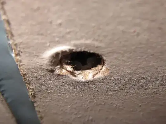

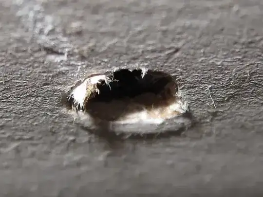

I hired a company to hang drywall on my ceiling and then finish all surfaces so I could paint. Included are pics I took of a few of their more excessively-sunken screws. I said to one of the guys, "Not to criticize your work, but aren't you driving the screw too deep?" He said, "The head of the screw can't be flush to the drywall surface. You have to countersink it like this so that you can mud over it."
I agree with that statement, but what I've learned is that you're supposed to dimple the screw in, not drive it through the paper. In these pics, it definitely looks like the heads broke the paper.
Does this require repair to be considered a sound installation?
This is type-x gypsum. I think that brown color you're seeing is from the fibers of the paper being pulled into the hole.

    Is this regular sheetrock or some type of fiberboard? The surface looks too rough to be sheetrock and I don't see any gypsum under the surface paper. – shirlock homes Nov 15 '12 at 10:52
  • You'd be surprised by what details are revealed in macro mode with a good digital camera. This is type-x gypsum. I think that brown color you're seeing is from the fibers of the paper being pulled into the hole. – oscilatingcretin Nov 15 '12 at 11:01
  • Ya, very detailed pic. fooled me. – shirlock homes Nov 15 '12 at 11:53
  • I have seen diy jobs with a “drywall screw setter” (about 50 cents to a dollar each) that look better than this. Using a battery drill or impact driver. If the paper is broken the strength of the Sheetrock is compromised. – Ed Beal Apr 09 '22 at 17:41

Those screws are not driven properly. The screws need to be driven with a drywall screw gun or a dimpler bit in a regular screw gun. The screws need to be slightly countersunk with an indented dimple around the screw head into the drywall to hold some joint compound. The screws should not break through the paper.
The proper bit indents and stops driving the screw at the right depth automatically. What I see in your pics is badly torn surface paper with shards of paper higher than the rest of the surface. This will be hard to mud and make flush and smooth. Many of these are going to have to be indented with a strike from a hammer to create a void for the mud to go into.
The other problem with driving drywall screws with a regular #2 Phillips bit is that screws driven too deep will not have the holding power and the screws will pull through, leaving the sheet unattached to the studs. This is especially important when hanging rock on ceilings.
These are the proper tools and bits.
On walls I wouldn't worry too much, but to be honest, I'd never let that go on a ceiling. If some seem really deep, it could mean problems. If you're paying, then insist it is done right. It isn't gonna take long to rescrew it properly.

  • Wow, you got 16 up-votes! I think Greebo would have experienced similar success had I not deleted the other question he answered (sorry, Greeb). At any rate, do you guys think this is a huge deal? Is it something I should be worried about or complain about to the superintendent? In other words, is this ceiling a disaster waiting to happen? – oscilatingcretin Nov 15 '12 at 21:38
  • On walls I wouldn't worry too much, but to be honest, i'd never let that go on a ceiling. If some seem really deep, it could mean problems. If you're paying, then insist it is done right. It isn't gonna take long to rescrew it properly. – shirlock homes Nov 15 '12 at 21:51
    Evil and I have so many vote points now we really don't pay much attention to how many votes we get. – shirlock homes Nov 15 '12 at 21:53
  • Shirlock, would adding another layer of properly-fastened 1/4" drywall remedy the situation? I have a reason for wanting to do that. – oscilatingcretin Nov 18 '12 at 21:06
    @Osc: Yes, that would fix the situation if applied with long enough drywall screws. Also just putting in new screws with the proper bit and dimpling the torn ones with a hammer will work also. – shirlock homes Nov 19 '12 at 10:00
  • i would like to add that the holding power of sheetrocks is ONLY on the paper. If you go trought it it's a matter of time until sheetrocks fall. – Javier Nov 21 '12 at 02:38
