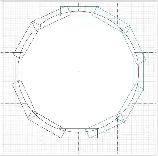

Poster is spray painting the ground..... Use a Template.
Mark a template where you DO have access to the center point. Accurate and no math....
Cutout the Template, on your scribe line.
Move the template where you want. Spray paint the cut edge for a clean crisp line.
Done.
a 25' circle, will only take 6 sheets of 4'x 8' materiel cut into 2'x8' pieces (Lauan,Cardboard,ChipBaord, etc), glue or Stapled together.
25' Circle with 12 2'x8' Segments for pattern
