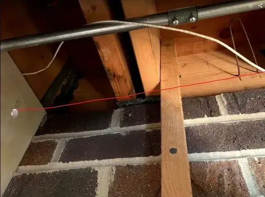

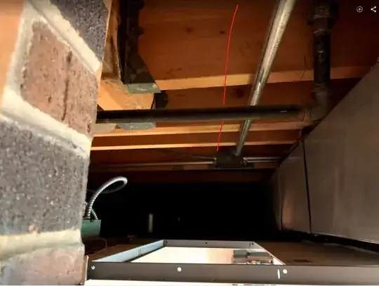

I am trying to run some cat6 cable in the drop ceiling of my basement. I want to run 3x CAT6-CMP cables that from what i understand should not rest on ceiling tiles.
From what i have read, the support needs to be attached to something other than the ceiling tile grid. J-hooks seem to be recommended/easy but i don't really understand where and how they need to be attached.
I have attached a couple of photographs of the area , i have highlighted in red the direction in which i want the cables to run.

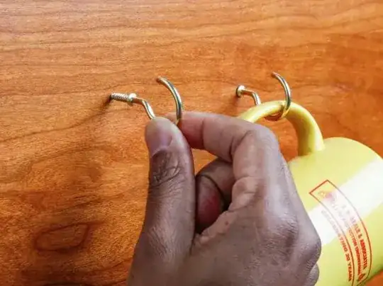

Simple cup hooks will suffice
$5 for a pack of 25.
enter image description here src
If screwing into the bottom, then at the first joist, you have two of them about an inch apart, and you face them opposite directions (not like in the photo). That way, to get the cable into them, you have to zig-zag it. This assures the cables will not escape.
Then every couple of joists, you have another hook, and alternate which way the opening faces.
If the cable will make a bend, face the openings outward of the bend obviously (won't work the other way).
These are trivially small and will not have any impact on the strength of a joist.
Note that I'm not talking about planter or light fixture/chandelier hooks, which are quite a bit bigger and justify a pre-drill and some sort of weapon to drive them. These are too small to power-drive, you'd either snap them off, or overshoot the mark.
    My only gripe with this is that while it's cheap, it's a slower install (drill hole and hand screw hook) If you have to install dozens of these, it will be much slower than a metal wire clip + screw – Machavity Nov 03 '20 at 14:35
    @Machavity subbed an edit for approval with some tips for driving hooks.. Can either use a hook bit (looks like a Y with a groove cut in it) or simply clamp a hook into the chuck and link it to another hook held against the wood – Caius Jard Nov 03 '20 at 19:10

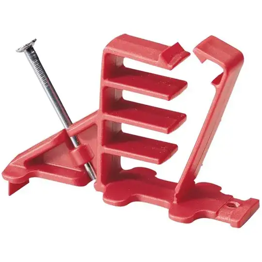

I like using these in my attic, even though they are designed for Romex. I like how they can clip multiple cables in.
Sometimes I replace the nail with a screw for easier installation.
Multi-Cable Staples (20-Pack)
