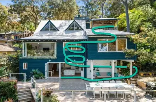

I have bought a new house (5 bedrooms on a steep slope). There is a road above with a double carport for the house which has garbage bins in it. The kitchen and deck is about 15 metres below the carport level.
I'm thinking of installing a zip line with an electric winch to transport garbage up and groceries down to the kitchen to save me lugging them up and down.
How feasible is this? Most winches I've found have a fairly short line length. Is it safe? Is it something I should get a professional in to

    As far as the question itself goes...it seems a bit open-ended, but...I would be leery of a simple winch-operated hoist. Without additional engineering, it would be hard to make sure loads are secured, and that they don't sway around and run into things. Might as well look at some sort of dumbwaiter/elevator setup. Or just enjoy the exercise. By the way, the one photo you've provided doesn't really offer much context. I assume that's the carport in the upper right, but I can barely see it, never mind is there enough detail to understand what challenges might be involved. – Peter Duniho Nov 03 '20 at 01:00

  • Needs a lot more detail, but it's a _nice_ looking place! Enjoy! – FreeMan Nov 03 '20 at 13:34
  • If you're not going to leave your photo up, which provided what little detail there is in this question, I suggestion you just delete the question. – isherwood Apr 28 '21 at 18:53
  • Don’t have enough rep – WOPR Apr 28 '21 at 22:11
