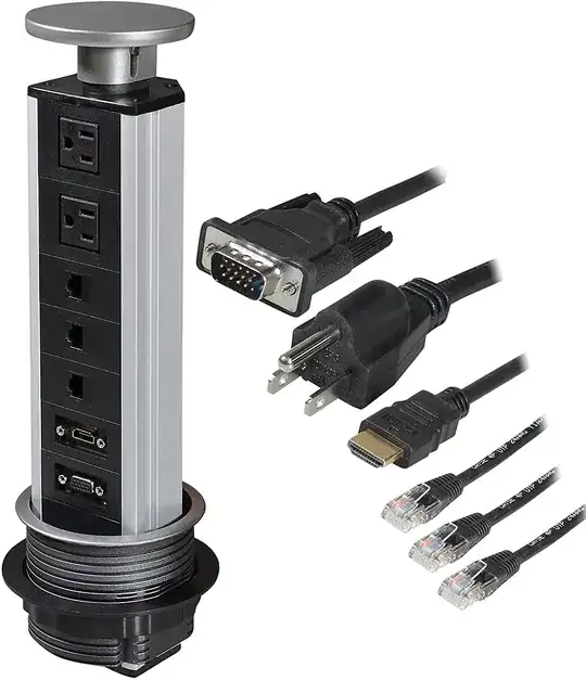

There are ready made desk items search Google for "pop up desk cable hidden". You could either modify one or may be able to buy an empty one.
Images from Amazon:Hinge type
Lift type
Bonzo
  • 281
    Please include the source for your images. – FreeMan Nov 05 '20 at 19:21
  • These look like they'd do exactly what I want, but I think they're a bit too small for my application... unless there are larger versions of the same thing out there – Bamboo Nov 05 '20 at 23:41
