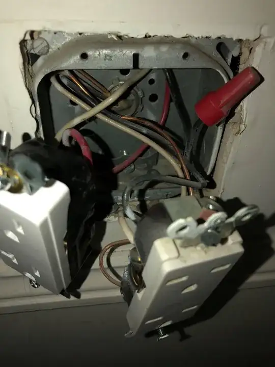

Flip the electrical socket over
Turn main breaker off, make sure both sockets are dead, 1 coverplate screw, 2 yoke screws, rotate 180, put it back in. Don't even need to take the wires off (actually: don't).
Now your appliance cord is working as intended: giving a flush-to-wall socket that you can back furniture up against, yet allowing both sockets to be used.
