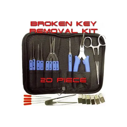

A locksmith would use a key extraction tool to remove the key.
Tool picture

  • Well, that would probably do it but it looks pretty expensive. Is there a tool at the local hardware store that would suffice? – Carey Gregory Nov 19 '12 at 05:29
    You can get some cheap lock pick sets I bet for under $20... really all it is is small, sturdy metal tools – Steven Nov 19 '12 at 13:06
