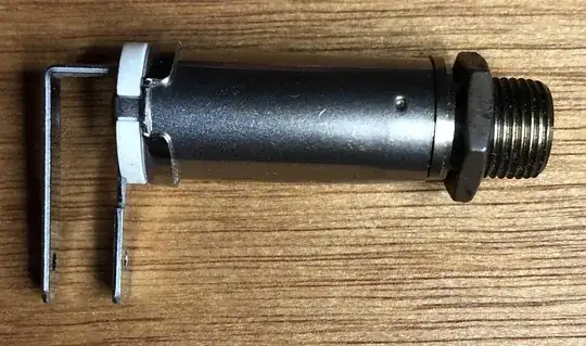

I am in the process of replacing the controller for a jenn-air oven. Ever curious as I am, I was poking around the wiring for all the sensors and elements, tracing them out, and learning their function. Then I came to this, and I have no idea what to make of it: image of a one-quarter inch headphone jack image showing the location of a headphone jack inside an oven
It is a 1/4" phone jack. INSIDE the oven. I am puzzled. Is there an option that uses this method to connect? Is some engineer at Jenn-Air trolling me? The connection on the controller PCB for this device is labeled "MT"... and the jack was (of course) empty. What is it for? Why is it there?
