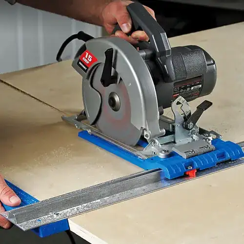

You can make straight cuts parallel to an existing edge by using a circular saw with a guide.
saw guide
To make the bottom edge of the cut clean, be sure the saw does not cut much more deeply than the thickness of the material. You can also put tape on the cut line, before cutting, to prevent the saw from breaking off small pieces of the material on the top edge of the cut.

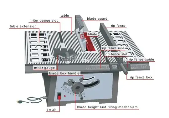

If you want to rip it (cut it on its long dimension), the only way to be sure it is straight is to use a table saw:
table saw diagram

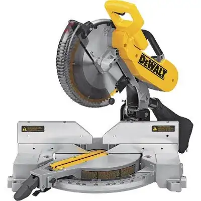

If you want to cross cut it (on its short dimension), you can do that with a miter saw if the piece is not too wide:
picture of miter saw
