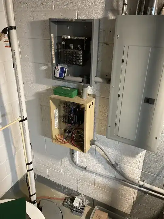

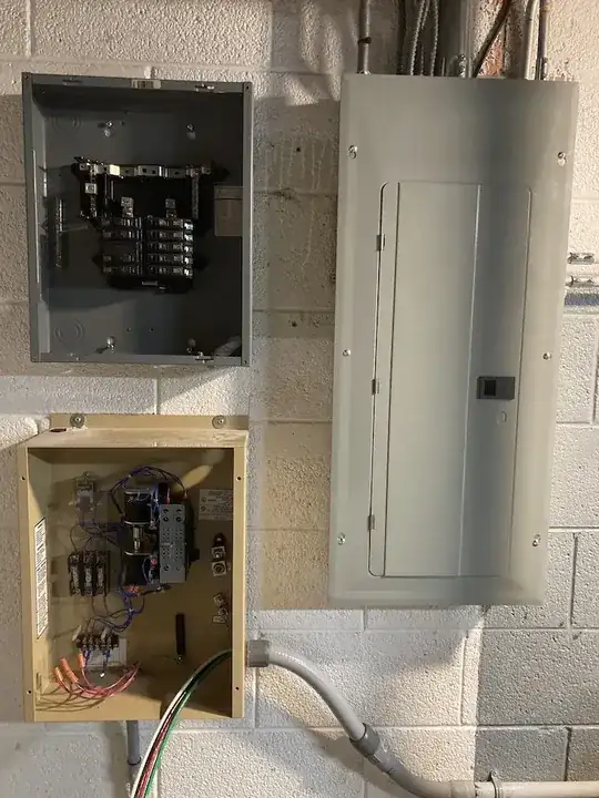

I purchased a used Generac 10kva with a transfer switch and am in the final stages of getting things setup. The generator itself has a 45a breaker on it and I've got 6 ga wire running from it to the transfer switch along with the 4 control wires. The gentleman that I purchased from said on his main panel he had a 100a breaker running to the transfer switch and then the sub panel shown was off the switch. Given that he has the 100a breaker, I'm in belief that I should be running 2 ga wire from the main panel to the switch for utility and then 2 ga again from the switch to the subpanel. What just seems super odd to me, is that the breakers on the subpanels always look to well exceed the output of the generators.

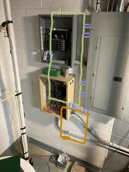

To connect the panels, I was going to run 1-1/4 at the bottom of the main across to the transfer, another 1-1/4 at the top from the main to the subpanel for the moved circuits and then 1-1/4 between the two panels for the subpanel feed.
Pics of my setup
Main Panel Sub Panel Xfer Switch
Main Panel Farther Back
Main Panel Open
Main Panel 3
Main Panel 4

You appear to have an automatic transfer switch, and the switching happens there. The 10? 12? space subpanel is just an ordinary run of the mill subpanel. It isn't special, it isn't matched to the transfer switch, or anything like that.
However, it is the long experience of the experts on this forum that you will find the "only 12 spaces" very stifling later down the road, and you will regret not upsizing that subpanel now while you have the chance. A 30-space is not excessive. Really.
Note that if you buy the same type of subpanel as your main panel, you can simply move the breakers over. This will save a ton of money if any of them are AFCI or GFCI breakers! You could not move them into the pictured subpanel without replacing its plain breaker with a GFCI breaker for that panel type.
I realize there is a mentality among generator owners that only a precious few circuits can be on generator; that's not true at all. It is sourced, however, from something barely related which is true, but we'll come back round to that.

If I went with a large subpanel, I would position them like this. Place the ATS first so the knockouts line up, only an inch or two below is fine, just so the lids will fit on. Place the subpanel second so it lines up with an ATS knockout, then have it vertically align with the main panel. I'd put several short EMT nipples between the panels, they're a real lifesaver when you need 'em. Metal conduit nipples among the panels mean grounding is taken care of; one less wire to have to mess with.
  • Great feedback here. I added a few more pics, one from farther back. So the thought is I could drop an Eaton BR 100 panel of the same size on the left and move the ATS below the main. The main really then will be empty. OR do I get a new main box, drop existing down and put the ATS to the right... – andyknas Nov 23 '20 at 04:16
    I wouldn't mess with replacing the main if I can avoid it. That is a much bigger project and much harder to DIY. If anything I would lay another similar sized Eaton BR panel right next to the main and move the ATS below both of them, assuming flooding wouldn't be an issue. Also, here's a tip: if you use EMT metal conduit, it's a happy medium between "easy to work with" and "legal grounding path". That eliminates need for one wire. – Harper - Reinstate Monica Nov 23 '20 at 04:24
  • I am slightly concerned with a space issue, to the left is a sump pump with a concrete cover, and to the right is the drain pipe. (added more pics) The original intent was to get a new Generac unit with ATS that could go outside with the service feed going direct. Saving money made things more difficult on the install. – andyknas Nov 23 '20 at 04:43
