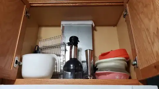

I had the exact same problem. I used a 3.5" x 10" rectangular duct to go up through the cabinet into the attic. In the attic, I used a rectangular to 6" round adapter, then 2 adjustable elbows to get the right offset and angle to line up with the roof vent, and a straight pipe from the elbows to go up through the roof. Bonus... I still have enough space in the cabinet to use it for storage.
I wouldn't recommend flex duct because all the ridges will collect airborne grease being sucked up from the stove. enter image description here
