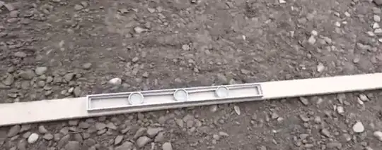

The way I leveled it is using a long 1"x8' board and a 2' level. I roughly leveled the subsoil to have a slight grade for drainage, tamped it. Roughly leveled a central 4"-deep pad of crusher run with a slight consistent grade for drainage, tamped it. Then more carefully did iterations of filling edges with #2 stone and topping it all off with another few inches of crusher run. I raked, scraped, tamped, leveled using the board, and repeated, aiming for a completely level surface. Board and level shown below:
board and bubble level on gravel foundation
I am asking about how to check if it is good enough now. I put the board down with the level in the middle of it, and I checked level in 9 location with the board east-west (16+ft length) and another set of spots north-south (8ft length). In each location the bubble is either balanced, or has only a slight dip on either side (I can pick the low side up 1 inch or less and get the bubble balanced).
I figure the bubble does not need to be perfectly balanced everywhere, it is good enough to be mostly balanced or within an inch of balance in all locations. My reasoning is that the shed will sit on long skids thus distributing its weight and 'averaging out' the slight (0-2 inch max) dips or rises that might remain over the whole area. Also, even if I got it perfectly level at this point, settling may not be perfectly even, so level within an inch seems good.
Is this foundation level enough to receive a shed? If not, what steps should be taken to get it even more level, or what measurements should be made to ensure it is good enough?

    1 inch over a 2 foot level doesn't strike me as particularly even. – FreeMan Nov 24 '20 at 19:32
    @FreeMan ;) If i understand correctly, the level was on an 8' board. A garden shed on skids does not strike me as requiring better than 1" over 8'. – Alaska Man Nov 24 '20 at 19:42
  • I describe the "string and stake" method here. It works. Just set your strings dead level rather than sloped as in that question. https://diy.stackexchange.com/a/52671/18078 – Ecnerwal Nov 24 '20 at 19:48
  • What are the specs on the prebuilt shed? I would purchase a laser level or similar type of device and measure both directions. Pre built have to be quite flat but built on site can be a foot off. Check with your manufacturer but a self leveling laser level can be found online for 30$ or less measure both directions to assure accurate measurements. – Ed Beal Nov 24 '20 at 19:53
  • Thanks for the input folks. @FreeMan, as Alaska Man said, I used the 2' level in the center of an 8' board. – cr0 Nov 24 '20 at 23:53
  • @EdBeal the shed is 8'x14', built on 4"x6" rough cut larch skids with larch or hemlock floor joists 16" on center. I understand it is built to be flat, and so the site it is placed on is expected to be level. – cr0 Nov 24 '20 at 23:54
  • If you have it compacted I would want it closer than 1” and I would be measuring with a transit or laser level. I haven’t purchased one of these but a friend did quick since he did not have to do the work. – Ed Beal Nov 25 '20 at 00:16
  • @EdBeal I am tamping the gravel down with a 10x10" hand tamper, so it is not heavily compacted but also not loose. I will look into using a laser level to try and work out any smaller dips and mounds. – cr0 Dec 01 '20 at 14:41
