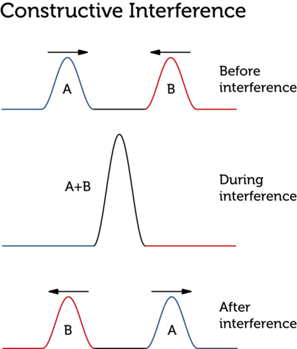

To add to the other answer, your two phases are 180 degrees out of phase so that it creates what is called destructive interference
Destructive Interference
Now this doesn't totally fit because your electricity is all flowing in the same direction, but the same principle holds. Note that wave A and wave B are completely canceled out. Even with the two waves running in the same direction, they null one another out.

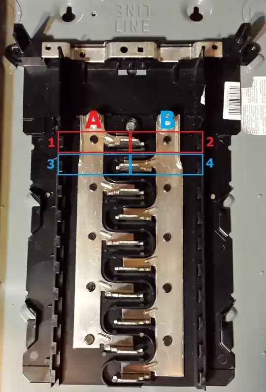

When you look inside your electrical panel it typically looks like this
Note how each bus zig-zags. This is so you can put 240v double-breakers in. Note how slots 1 and 3 each hit a different phase. It sounds like they're using something like slots 1 and 5 which creates constructive interference
Constructive interference
Thus your neutral now gets that double load manassehkatz talks about
