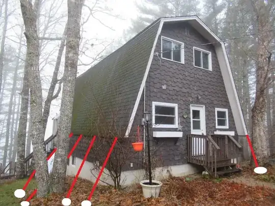

The south side wood wall is bulging out near the center. Although not clearly visible in the photos it is certainly visible in person. Check the pink arrow and the photo with the level. Anyone ever come across this kind of thing before?

  • The roof clearly bulges in tandem. You can see it in the photo. Unfortunately, this is a drawback to this kind of severe roof design. Either exterior buttresses or interior rafter ties come to mind as possible solutions, but I'm not terribly knowledgeable in this type of structure. We'd at least need to see more of the interior. – isherwood Dec 01 '20 at 14:28
  • Basically the inspection report told you all we'll be able to tell you. Get someone on site to look over the joist-to-roof connection. My guess is that that's the point of failure. You may end up using heavy machinery or bracing to restore the wall's position as you reconnect that area inside. – isherwood Dec 01 '20 at 14:37

  • The building inspector is accurate and his suggestion is good. The issues are with the wording and the interpretation of it. By 'adding a concrete pilaster' he means a horizontal bracing element at the mid point of the wall (more accurately a buttress). This to resist the outward thrust of the roof rafters – Ack Dec 01 '20 at 17:05

The roof is slowly pushing the wall outwards. If you have not purchased this cottage yet then either walk away or low-ball them. I foresee that subcontracting a proper fix easily reaching $10k.
You need to do two things:
  1. Straighten the wall out
  2. Prevent the wall from bowing out in the future
To straighten the wall out I imagine you would need to attach a bunch of steel cables on the inside of the cottage and tension them enough to pull the walls inward.
For preventing future bowing you have two options really:
  1. Brace the roof from the outside
  2. Tie the roof together from the inside
Whether or not this is a project you can take on is up to you.
Option 1:
The red lines are extensions of the roof line; you can use pressure treated wood or preferably steel beams. The white circles are concrete footers.

I'm not sure why the inspector suggested a concrete pilaster since your foundation does not need bracing but rather the exterior wall but then again I'm not an expert.

  • I agree, in principle, with both of these suggestions, however, they both need a structural engineer to ensure they're designed properly, and that any interior structural damage is properly repaired. – FreeMan Dec 01 '20 at 16:48
  • @FreeMan Thanks, I think I addressed that with my $10k estimate and later do advise consulting a structural engineer in my answer. – MonkeyZeus Dec 01 '20 at 16:50
  • yup. gotcha. Sorry, I read this earlier, then just skimmed when I saw it had been updated and missed it this time. Never hurts to reinforce the "Be Careful" message! – FreeMan Dec 01 '20 at 16:55
  • @FreeMan No sweat, will do! – MonkeyZeus Dec 01 '20 at 16:58
    Thanks for weighing in! I appreciate the illustrations. – SPS Dec 01 '20 at 18:29
