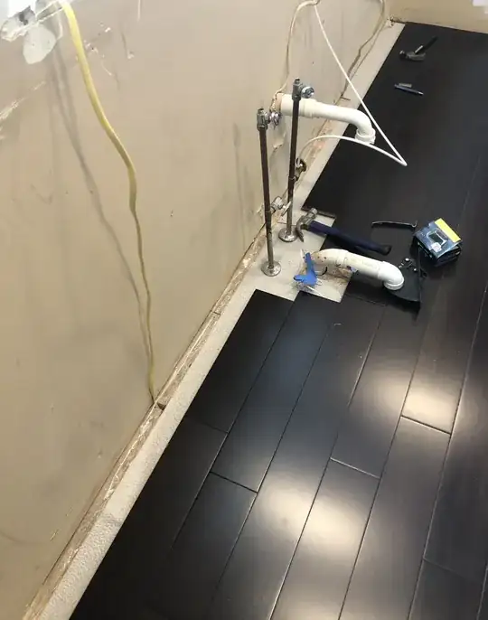

I’m putting in hardwood floors and I am at the spot where kitchen cabinets would go. The last strip is going to be narrower than whole flooring boards, and usually I would rip the boards going elsewhere in the room. Should I just leave the last few inches of floor exposed? What is the downside? It’s a second level of the house with joists and osb. I am also leaving some exposed parts around plumbing and central vac pipe. Does this look good? Thanks!
EDIT: flooring is not floating, it’s nailed down 11/16 thick hardwood.
EDIT #2: Wow, I didn’t realize I was starting a topic that was so controversial! :) I might as well asked what was better PC or Mac. I ended up finishing to the wall with some gap for expansion (though type of hardwood I am using doesn’t really expand). Cabinets are in and it did actually make the leveling them easier. Thanks to all who contributed to this (at times heated) discussion!

It's not the end of the world, but you might consider cutting the pieces so the gap is smaller.
Why? Some cabinets sit on the floor via little legs. If the legs were to be exactly where there's no flooring, it becomes uneven. You'd then have to put something under it the right thickness, which just happens to be your flooring.
If it were me, I'd spend the extra few minutes and rip the pieces to within maybe 1/4 inch of the wall (for expansion/contraction).
    that’s definitely a good point. Cabinets coming in literally tomorrow and had other parts of the kitchen that were a priority. End pieces usually are the ones that take me longest as I have to manually nail pieces before last to the point that the tongue and groove can slide together properly. I then glue last pieces. I should be able to find extra time in the morning to fill the gap. If nothing else it will make me feel better - hate half assing a job. – David Dec 02 '20 at 04:09
    The reasoning is good. The final answer is incorrect. The cabinets should go on subfloor only. This has not been thought out well. – DMoore Dec 02 '20 at 15:14
  • @SteveSether - That is correct. That is why I didn't downvote your answer. There are sufficient/make-do ways and there are best practices. Installing on top of hardwood is certainly not a best practice - and for sure not on prefinished hardwood. – DMoore Dec 03 '20 at 06:00
    @DMoore. Well considering two spaces on either side of the sink will house dishwashers, I’d rather not be sliding over some planks when servicing one. Cabinets directly on the subfloor is possibly the least common way to have it done. The two houses I have owned (both built after 2003), both had floors put in all the way to the wall. One by a regional developer/builder and one by a smaller builder. – David Dec 03 '20 at 13:13
  • @David - if I was a builder I would make you pay for floors all the way to the wall if I could too. I get more money, it is an easier install, and dont have to worry about installers messing up. Your dishwasher comment really makes no sense. To adjust the legs on a dishwasher it takes about 1 min. This is a very very normal thing to have to do. Out of all of the reasons to have leakable fixtures on a finished floor, this is not one. Let me be more blunt - I have never seen prefinished hardwood ran under a sink wall. – DMoore Dec 03 '20 at 14:02
    I've experienced appliance feet/wheels dropping off the "back" of flooring laid like this and it's a real pain. Another factor is water leaks - if a pipe leaks it can travel under the flooring un-noticed rather than running out along the surface and becoming obvious quite quickly. – John U Dec 03 '20 at 16:04
  • @DMoore, why would a builder finish the floor under cabinets in a market house, when they would not get paid extra no matter what? Anyway, this particular wood is a very dense Cumary (Brazilian teak) finished with polyurethane, This hardwood is even used on exterior decks. It is nailed down very tight to an EcoSilent underlayment with a moisture barrier that is pretty much sealing it in-place. If there is a leak, water will most likely come out from under the cabinet and puddle the floor surface where I will see it, or it will go behind the counter to the basement and I will see it. – David Dec 03 '20 at 19:08
  • @JohnU In my case, it was a good thing that the kitchen tiling didn't go all the way to the wall. The power cord on my oven was too long and curved underneath the oven so much that it prevented the bottom drawer of the oven from closing. Since there was a gap between the tiling and the wall, I was able to push the cord back so that it tucked into the gap, allowing the drawer to fully close. – pacoverflow Dec 07 '20 at 17:59

That is just fine. The only possible downside is that if you decide to re-arrange the kitchen in the future and the area will become "uncovered", you will have to deal with it at that point. Maybe make sure you keep enough of the flooring around to fill in the remainder if needed.

We do not install hardwood in kitchen under cabinets on the plumbing/gas wall. Your last row should sit about 1/4" from cabinets - you may need to rip these planks.
I am a little perplexed at some of the answers and advice here. This isn't a hard question.
  1. In Europe we do... No you don't. I have done many renos in France and spend a lot of time in the UK and Italy. There isn't hardwood in kitchens and if there is it isn't under the main plumbing or gas appliances (islands). Most people in Europe tile their kitchens fully - which is a whole different ballgame and the right way to tile. Reasoning here is in a lot of parts of Europe you bring your kitchen with you (although this is changing).
  2. What if we change the layout? No you won't. You aren't changing your main plumbing wall or gas wall in a kitchen. If you do you are tearing out the floor anyways 90% of the time.
  3. Why not just put flooring under? This is really simple. Because it only begets problems. So the plumbing is there, a sink, stove, whatever. You have cabinets (weight) on top of the flooring, probably nailed or screwed to the floor in some way. You get a spill or some water... You can't see it because cabinets are on top, the wood expands a bit and now you have possible buckling on that plank, that is also outside the cabinets. For what? What is that flooring doing underneath the cabinet.
  4. Well... There is only one reason you would put hardwood flooring under this cabinet wall. If the cabinets were on exposed legs - meaning you can see under them. This gets rid of problem #3 and obviously you need the flooring for aesthetic reasoning.
Ask yourself this - If there is a leak under the sink or dishwasher and it ruins part of the flooring and that flooring being expanded ruins more... are you going to take apart all of your cabinets and appliances to "fix" the issue right? (no you will patch that part or just remove it)
Another Note: You have really nice prefinished hardwood yet I see a line for your ice maker coming up through the floor. The ice maker line flooding is one of the top insurance claims on houses and will ruin these floors quickly. While things are open you should install a proper shutoff box to help neutralize this problem.

However, I think you'd be OK leaving it like that. The majority of the cabinet's weight will be sitting on the new flooring, so you're not likely to have any tipping or other issues with setting your cabinets.
If it were me, though, I'd probably rip flooring to mostly fill the gap to the wall. It doesn't have to be a precise fit since it will be hidden, but close enough that I could cover the gap with thick baseboard if necessary.
As for the gaps around the plumbing, I'd say you're fine there, too. It will all be hidden by the bottom of the sink base, so nobody will see it.
I would go all the way to the wall so the back of the cabinet has something to sit on. Nice job BTW.

You absolutely, should install the flooring all the way to the wall, in both bathrooms and kitchens. However, this opinion goes against the building trade, because they never do it. I believe it is all about cheapness, and it's been SOP for about a century. If you want to do future remodeling, or if you simply want to pull your stove or refrigerator out for cleaning, the task is a breeze with appliances that sit on finished floors. The worst offender of all here is the dishwasher. It is the hardest appliance of all to move when it sits on an unfinished floor. In your bathroom, you may want to replace a traditional sink with a more stylish pedestal sink, and doing this work now saves you a headache down the road (for some reason, only toilets sit on finished floors). The only downside to this idea would be if your sink or kitchen appliances sit unevenly on the floor due to grouting areas, or slate flooring texture. A skilled floorer wouldn't like the idea because the sink sits best on a flat floor. However, it's just a little faux pas, it takes an expert's eye to see, and, if needed, it can be covered up by caulk.
@kojiro made a really good point in the comments, and this was originally just going to be a reply, but it's too long for that...
If OP (or future owner) ever wants/need to replace an appliance, they might be limited to those with exactly the same dimensions as the old one. The change in height will look bad if a smaller unit is installed, and it might cause leveling issues if the footprint isn't the same (smaller or larger).
And, as mentioned in the comments, it might be extra unpleasant to find that this "lip" in the flooring is working to box the old appliance in place. That is part of the reason I still have a dishwasher from 1992 (well, that and it still works, but I don't think I'll be getting warranty service on it).
If you do decide to not bother with the trouble of ripping all those boards just to cover them up, I can't blame you. But you'll do yourself and any future owner a HUGE favor if you stash away some extras in the attic with a note that explains what this little stack of boards is for. Always good to buy some extra tile / flooring / molding / fencing / siding / shingles etc...
