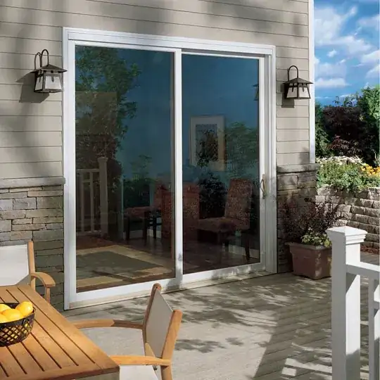

We are going to hire somebody to replace our sliding glass patio door. Its a standard sliding glass patio door, similar looking to this:
